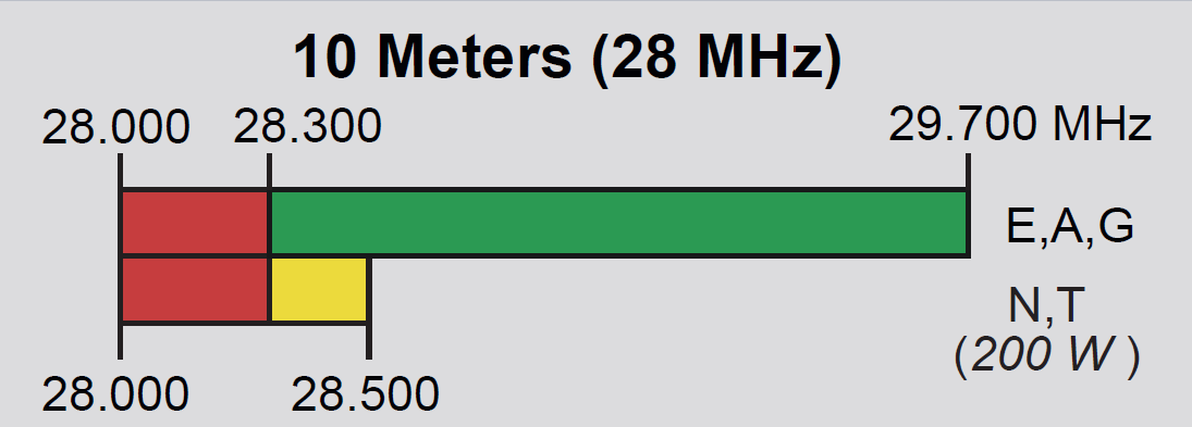

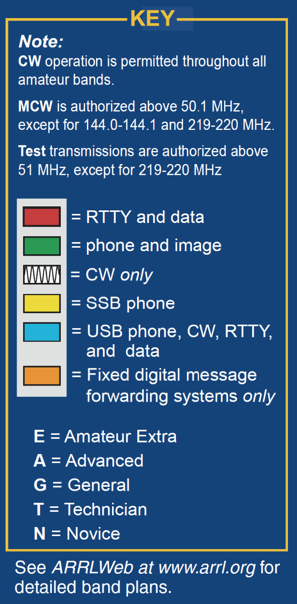

marcspaz Posted December 20, 2025 Posted December 20, 2025 19 hours ago, WRYS709 said: No one does FM below the 29 MHz portion of the 10 Meters band. I am not sure if this is by custom or FCC Rule. 18 hours ago, TNFrank said: That's probably why I didn't hear anyone. § 97.305(c), combined with § 97.307(f)(1)(2)(10) are the only locations I know of that define the limits and standards of emissions types you can use on 10m. Per § 97.305(c), for frequencies above 28.3MHz, your emissions types are restricted to image and phone. The standards that apply to phone are § 97.307(f)(1)(2)(10). F1 and 2 do not restrict the type of voice emission you can use from 28.300MHz to 28.500MHz. Only the amount of power/bandwidth you can use, more or less saying 'don't over-modulate' as a loose translation. Now, § 97.307(f)(10) does apply and does restrict what modulation type you can use IF you have a Novice or Technician license. If you have either of those, you are restricted to CW (only using Morse code) and SSB. Specifically, phone emissions J3E (no carrier SSB) and R3E (reduced carrier SSB). The Band Plan gives it to you pictorially, which makes it easier to understand (I think). I attached the PDF, too. You will notice that Novice and Tech are also restricted to 200w, rather than the customary 1,500w. Band Chart - 11X17 Color.pdf Lscott and SteveShannon 2 Quote
TNFrank Posted December 20, 2025 Author Posted December 20, 2025 Also as a Technician it's 28.300-28.500 sideband only, not standard FM. jlwilkers 1 Quote
Lscott Posted December 21, 2025 Posted December 21, 2025 4 hours ago, marcspaz said: § 97.305(c), combined with § 97.307(f)(1)(2)(10) are the only locations I know of that define the limits and standards of emissions types you can use on 10m. Per § 97.305(c), for frequencies above 28.3MHz, your emissions types are restricted to image and phone. The standards that apply to phone are § 97.307(f)(1)(2)(10). F1 and 2 do not restrict the type of voice emission you can use from 28.300MHz to 28.500MHz. Only the amount of power/bandwidth you can use, more or less saying 'don't over-modulate' as a loose translation. Now, § 97.307(f)(10) does apply and does restrict what modulation type you can use IF you have a Novice or Technician license. If you have either of those, you are restricted to CW (only using Morse code) and SSB. Specifically, phone emissions J3E (no carrier SSB) and R3E (reduced carrier SSB). The Band Plan gives it to you pictorially, which makes it easier to understand (I think). I attached the PDF, too. You will notice that Novice and Tech are also restricted to 200w, rather than the customary 1,500w. Band Chart - 11X17 Color.pdf 183.74 kB · 1 download One has to pass a test to get a license. That also means at least do the basic research, read the rules and follow established band plans. These sort of questions are a bit disappointing when licensed operators know better. US Amature Band Plan 2020.pdf jlwilkers 1 Quote
TNFrank Posted December 21, 2025 Author Posted December 21, 2025 There wasn't any questions on the test asking about 10M so how would someone know better? Quote
SteveShannon Posted December 21, 2025 Posted December 21, 2025 4 minutes ago, TNFrank said: There wasn't any questions on the test asking about 10M so how would someone know better? Did you study the band plan? Remember, the questions on the test come from a much larger pool. Even if you didn’t get that for a test question, you’re still obligated to work within the band plan, even if it means studying something that wasn’t in the test. WRUU653 and Lscott 2 Quote
marcspaz Posted December 21, 2025 Posted December 21, 2025 Yeah, it's definitely up to us as operators to know what we can and can't do. Its absolutely in the rules, training materials, and the test pool (even if it wasn't on the test you took). I think the important thing isn't necessarily to remember everything, but rather the remember the stuff that impacts your day-to-day use while remembering there are resources you can use to check when you want to operate outside your normal routine. One of the things I love about the radio community is, we're not out here looking for "got ya" moments. We manage ourselves (for the most part) so we try to be the best steward of the community we can be by promoting education and supporting licensees who truly do want to do the right thing. Its how community works. All communities. WRUU653, SteveShannon and Lscott 2 1 Quote
