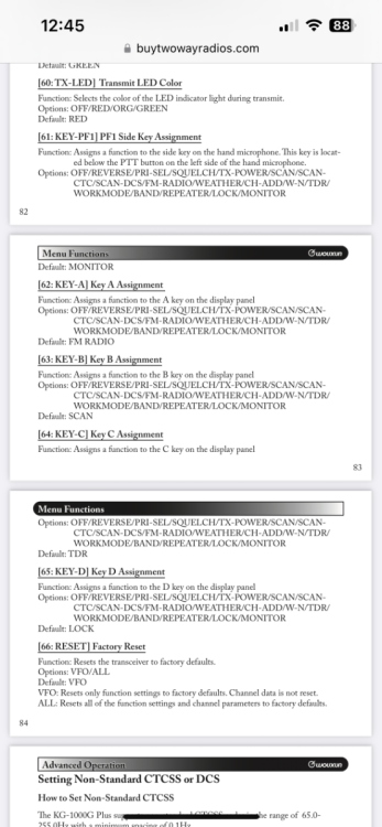

I know I’m going to feel stupid when I hear the answer, but here goes. How do you program the configurable buttons on the Wouxon KG-1000G plus?  The A, B, C, D buttons.  I have read the manual, tried pressing them in different ways and googled the shit out of this and can’t find an answer. Thanks.

Start on page 82 of the manual.

I was wrong and corrected my earlier post. I was thinking off the KG935G and KG-Q10H software. The KG-1000G/G Plus software does not allow one to change the A-D buttons. That can be easily done through the radio itself.
