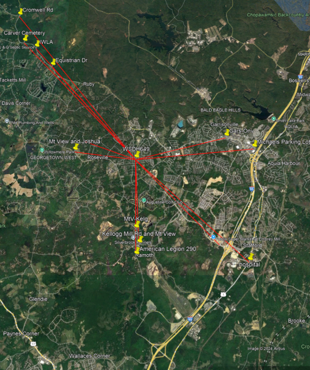

WSEM281 Posted October 21, 2024 Posted October 21, 2024 Looking forward to the upgrades and curious if I'll be able to reach out after you complete the new install! I've been trying for a few weeks to hit your repeater with a 5W HT from Ramoth/Stafford Airport...not much luck unless I hold the ht above my head and key up from various locations around my yard. Best regards. WSEM281
WSDH649 Posted October 22, 2024 Author Posted October 22, 2024 Good to hear someone is trying to use it. I think part of the problem with the system right now is that, especially south of my house, the trees are so dense and there are rolling hills. I can get good reports 5-6 miles north and east of the antenna but south and west it seems to only reach 3 miles or so before fading out. I may look at getting a taller mast in the new year if distance does not improve. DX engineering sells a 46ft telescoping mast that is affordable. But, I would have to build a solid anchor before I would order one. Probably that would require a permanent concrete base with a post that goes several feet into the ground. At least for me to feel safe raising it. Also, if I do that, I will have the 25 ft mast as backup or for a 2nd repeater or base station perhaps in UHF. I'm thinking about building a DMR repeater but it is more complex. Need to get this GMRS system working perfect first.

WSEM281 Posted October 28, 2024 Posted October 28, 2024 I tried again this morning and I'm only getting 6-8% on the RSSI meter on my 5W HT from ground level. Foliage and obstructions are the likely culprit. I did however get through to the repeater and was able to hear the rebroadcast. After looking at your map, I'm slightly E/SE of Post 290 on Ramoth. Was considering putting a magnetic antenna on the roof with a mobile as a base unit but I will likely be moving in the spring so the time, money, and effort could defeat the purpose.

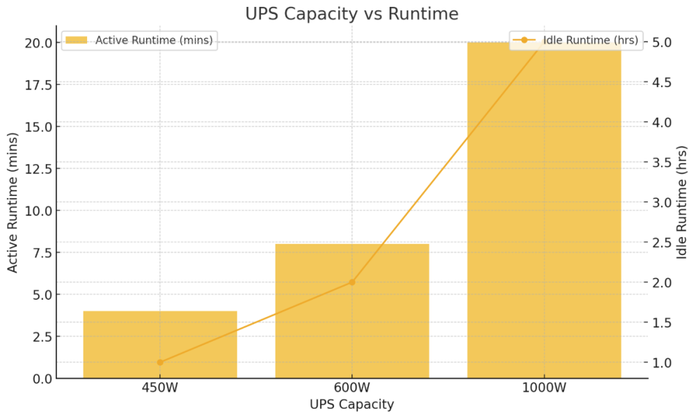

WSDH649 Posted November 24, 2024 Author Posted November 24, 2024 (edited) I am installing the ignition sense connection on the TX and RX radios tomorrow so the system will be down around noon for a few minutes while I take care of that. I have been monitoring power for my all of the critical equipment in my HAM shack. This is to right size UPS battery backup. Here is what I have put together from research. Not sure which final solution I am going with yet. But in any case, the UPS is only intended to hold until I can cutover to generator. Power Draw Reports Maximum Active Use: Everything Keyed up. Power: 329.4 W Current: 3.995 A Voltage: 121.6 V With 20% buffer: 395.3 W Idle Use: Power: 28.9 W Current: 0.429 A Voltage: 122 V UPS Recommendations To accommodate the power draw and provide adequate runtime, the following UPS options are suggested: 450W UPS (e.g., CyberPower CP1000AVRLCD) Active runtime: 4–6 minutes at 395W Idle runtime: 1–2 hours at 28.9W 600W UPS (e.g., APC BX1000M) Active runtime: 8–10 minutes at 395W Idle runtime: 2–3 hours at 28.9W 1000W UPS (e.g., APC BX1500M) Active runtime: ~20 minutes at 395W Idle runtime: 5–7 hours at 28.9W Here is a chart summarizing the UPS capacities, active runtimes (in minutes), and idle runtimes (in hours) for the system. - Barry WSDH649 Edited November 24, 2024 by WSDH649 signed
