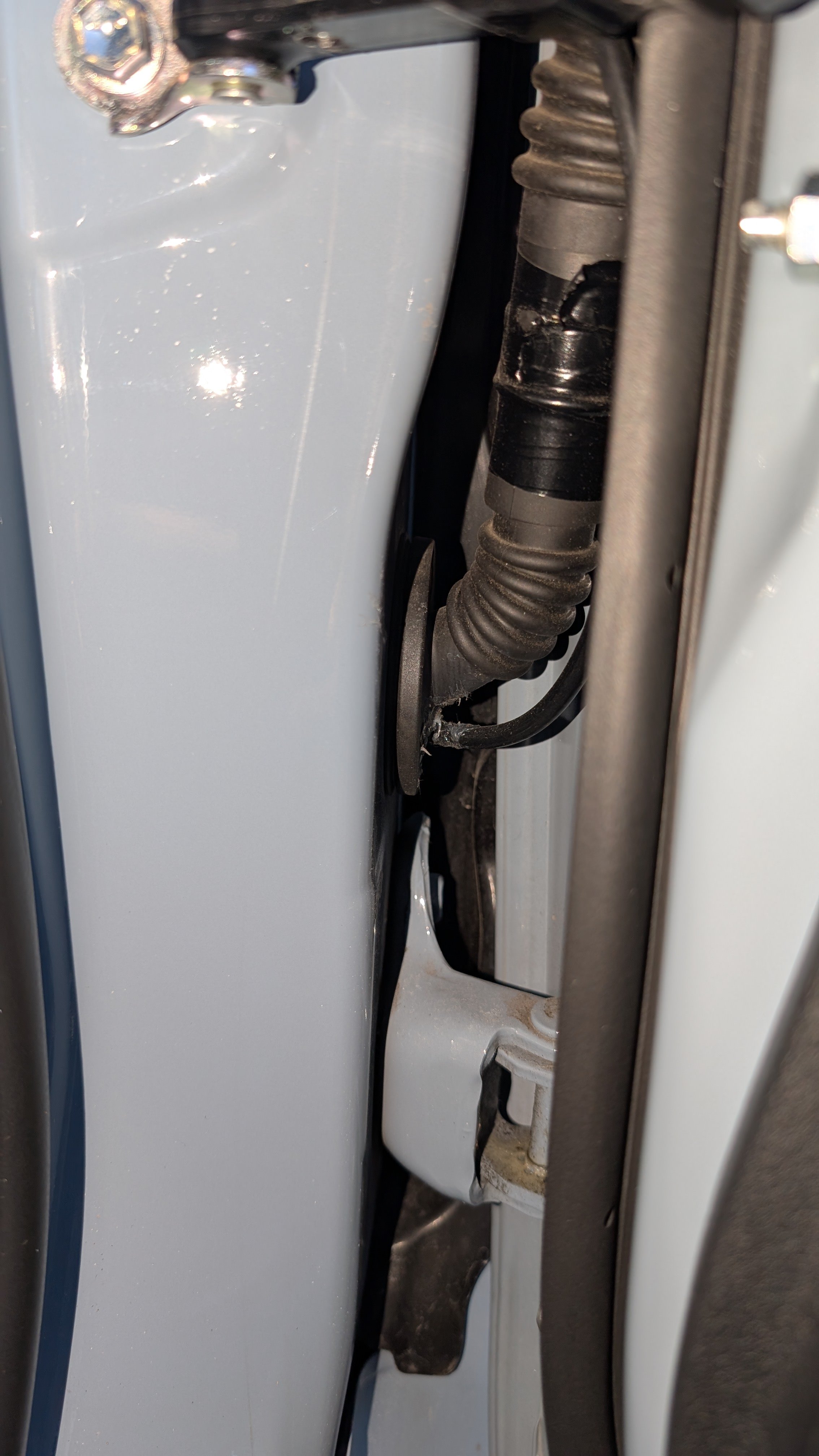

Cable run from my car's hood mounted antenna to inside through the door boot.
Very clean and short cable run with minimum modification to the car.
I pierced the rubber boot with an awl, pushed the cable through to the inside of the car and finished it off with a dab of silicone.
