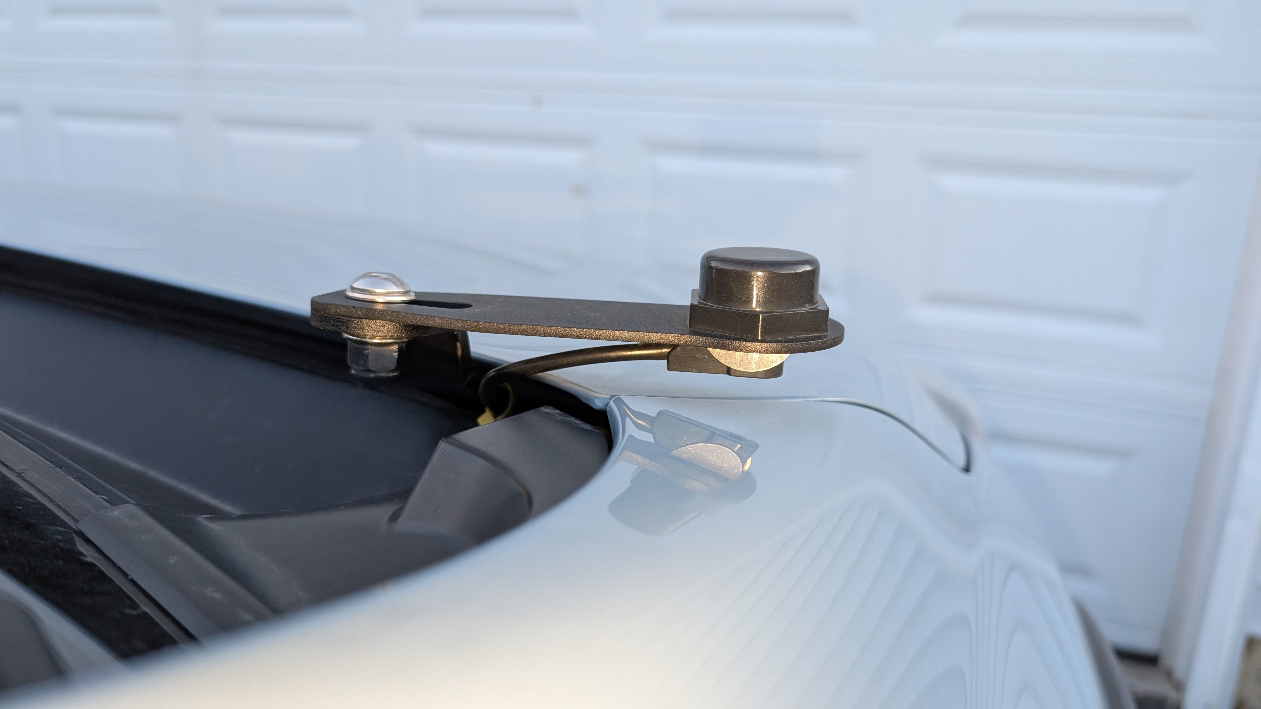

Antenna Mount for My Car using Midland MXTA24, ditch light bracket and ditch light bracket antenna extension.
I got too much stuff on my roof to mount an antenna there I decided to put one here.
Advantages:
Very short and clean cable run. (see pics)
No permanent irreversible modifications to my car
I can be stealthy using a Midland MXTA25 3DB MicroMobile antenna, switch to a Midland MXTA26 MicroMobile 6DB Whip for performance or just cap it off when not needed.
