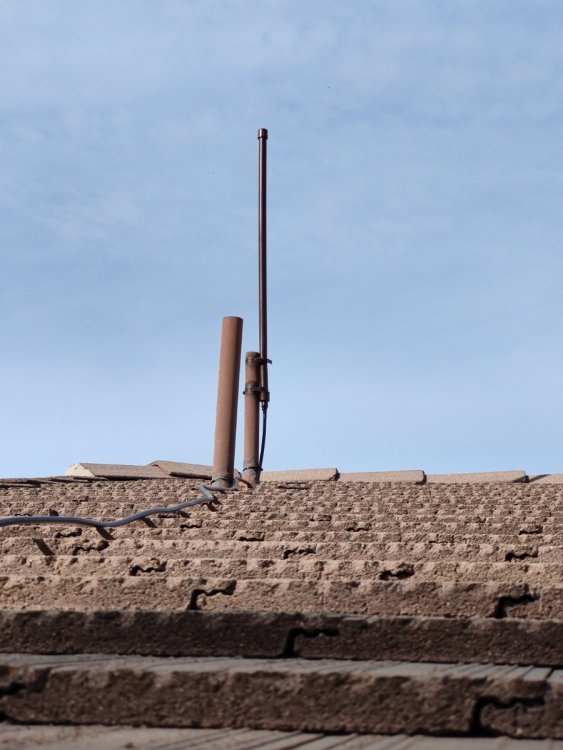

  2. Currently using an Ed Fong J-Pole painted and disguised to look like part of my roof vent due to HOA regulations.
