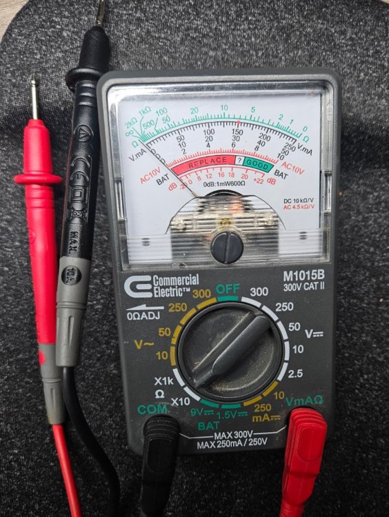

  20. Only thing on the screen is the info when you power it on. Nothing changes when mic is keyed
  21. I was using the green scale at the top. Is this correct?
  22. I misread your question. It looks like it reads up 2k. The actual reading is 6 or 7
