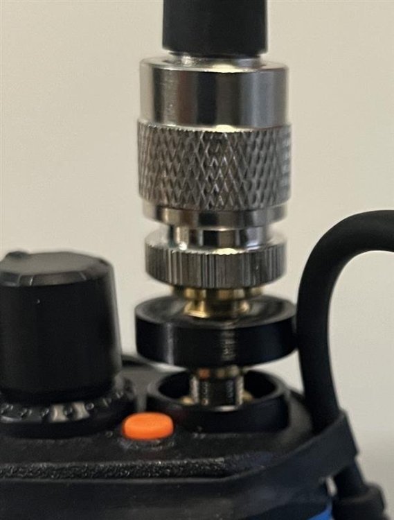

  1. Socalgmrs I had not really considered that as I have the coax hanging vertically from the above the radio in a fixed location. However, you make a good point, so version 2 is designed to prevent lateral torques while still allowing the collar to be used as a wrench for the SMA nut. Also has the benefit of no glue and is similar to adapters that I have made for other SMA mobile antennas (i.e. Retevis RHD-771) .
  2. Anyone else out there with fat fingers that have difficulty connecting an external antenna using a PL-259 to SMA adapter to their handheld radio? Here is the answer: 3D print a 19mm disk, 5mm thick with 8mm hex hole in the middle. Lightly coat the interior of the hex hole using a Qtip with cyanoacrylate (super glue), slide onto adapter N nut allowing glue to set for 3-4 minutes.
