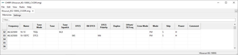

  2. Some updates removed the old CTC line. Recreated CTC line and added DCS line just in case. I was able to upload it to the radio. And can now transmit. No more "I can't do that" tone I have a Talkpod A36plus that I also programmed with these to lines. I have tested both channel settings. Can transmit/receive on each side. Now just to meet up with some friends that have a Rugged Radios GMR2-PLUS and find out what its using. Thanks for everyone's help.

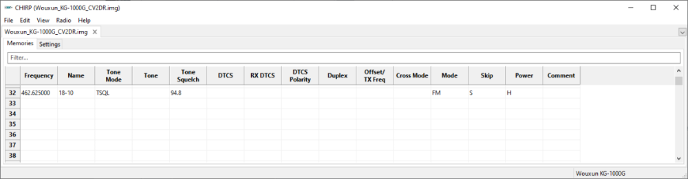

  3. @amaff you are correct I have the KG1000. Let me trim down the list Location,Name,Frequency,Duplex,Offset,Tone,rToneFreq,cToneFreq,DtcsCode,DtcsPolarity,RxDtcsCode,CrossMode,Mode,TStep,Skip,Power,Comment,URCALL,RPT1CALL,RPT2CALL,DVCODE 32,18-10,462.625000,,0.000000,TSQL,94.8,94.8,023,NN,023,Tone->Tone,FM,5.00,S,50W,,,,, Location 32, Name 18-10 is the one I am trying to get to work. I'm using CHIRP to program it and I just exported the config to csv. So I'm not sure why they show up in the export. It's not the case when I'm looking at them in CHIRP. I will go ahead and try cleaning it up and program one of each and test them.
