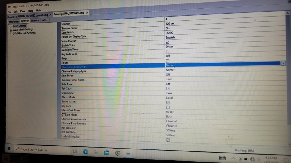

bscabl Posted 14 hours ago Report Posted 14 hours ago the uv-5g+ can save in names for channels and the radio itself can change display from freq / channel / name [programmed via chirp] I forget the exact but i think its menu 25 or close to that Quote
bscabl Posted 14 hours ago Report Posted 14 hours ago itll look like this when done.. WRUE951 1 Quote
423radioman Posted 14 hours ago Author Report Posted 14 hours ago 2 minutes ago, bscabl said: itll look like this when done.. Oh nice, read through the manual 5 times but must've missed that setting. Thanks! bscabl 1 Quote
Bogieboy01 Posted 14 hours ago Report Posted 14 hours ago There should be an option in the menu for naming the repeaters, i have my ar-5rm set up this way, witha ll the repeaters names... then it was just changing a setting in the menu of the radio, or in chirp for the name to show instead of the freq... bscabl 1 Quote
bscabl Posted 14 hours ago Report Posted 14 hours ago 1 minute ago, 423radioman said: read through the manual the appendix in the rear gives all the menu shortcut numbers and a brief descriptor of what they do. [it is menu 24 and 25 [one for a/b] Quote
bscabl Posted 14 hours ago Report Posted 14 hours ago 2 minutes ago, Bogieboy01 said: option in the menu for naming the repeaters i completely forgot that was there as well lol Bogieboy01 1 Quote
