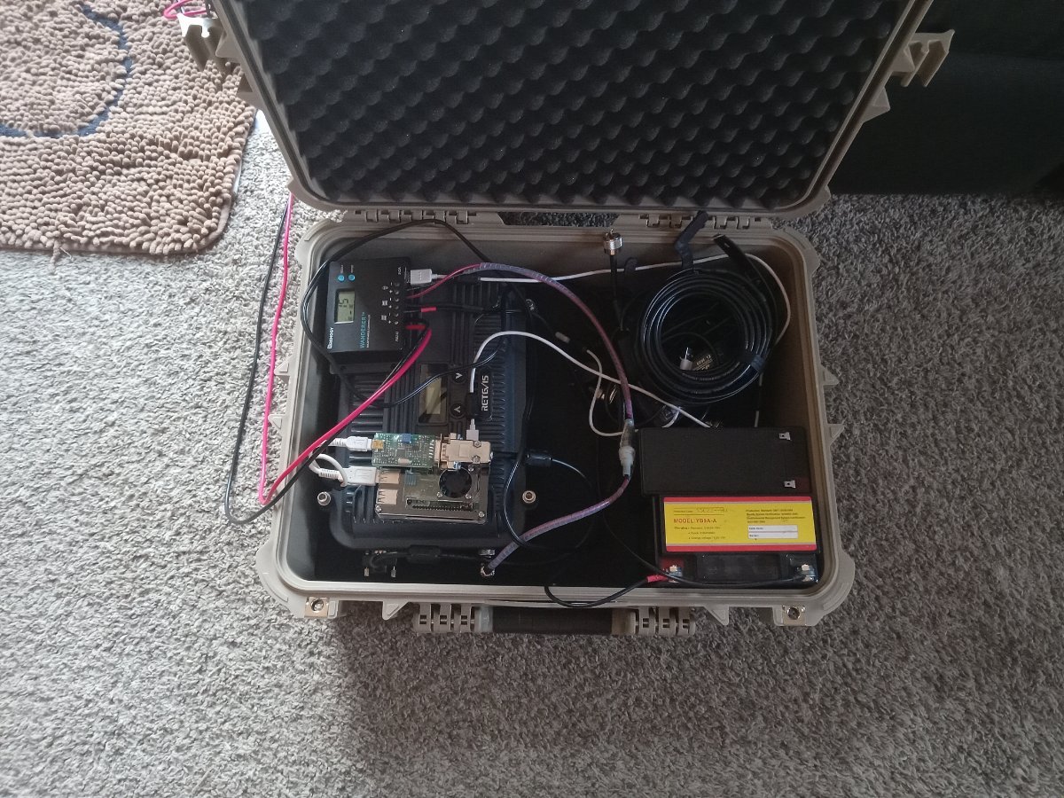

I love the Eco-worthy 20amp MPPT charger, is cheap and it works great, here is one that I made for campings, it gives me the option to charge the car battery and add more solar panels, underneath the charger I have (2) 12ah SLA batteries. They power a brushless fan, LEDS and ipads etc on my campings or out on the field adventures :D
CHECK OUT THE VIDEO
https://www.youtube.com/watch?v=Z-mKA2k4EN8
