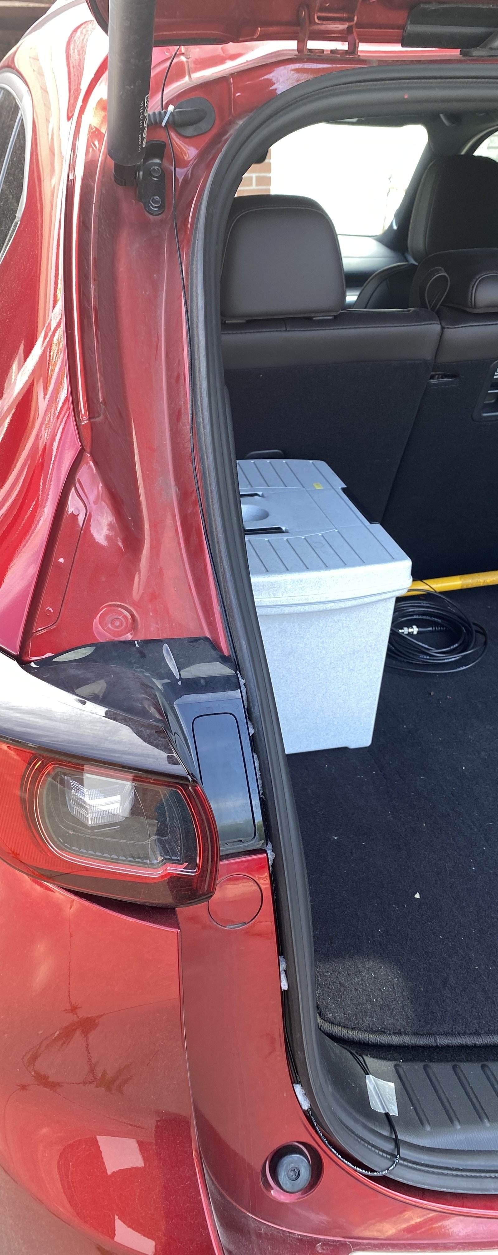

Used some Styrofoam stuffed in the narrow cracks to hold the thin coax in place. The gap between the tail light assembly and the hatch lip was too narrow to stuff even an RG-58 coax into it without having to really squeeze down the cable to flatten it out. That likely would have resulted in an elevated SWR. The only thing that fit was another mount with RG-316 cable. The losses where higher than I wanted, but I didn't have much choice.
