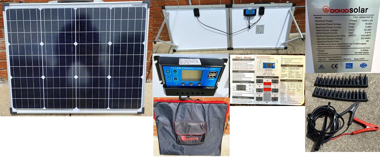

I got this at a local Ham flea market. I think I paid somewhere around $50 to $75 for it. For a 100 watt panel it was a decent price. As you can see it's a complete kit including the tot bag for transport. The charge controller is a basic PWM type. I would rather have had a MPPT one, but they are not commonly found due to the higher cost. People go cheap buying the PWM ones.
I'm planning on cutting the cables to the solar panels to add in some in-line Anderson Power Poles on short pigtails. This way I can just unplug the panels from the cheap Lead-Acid PWM charge controller and run them separately out to some of my LiFePO4 MPPT charge controllers.  If I need to use the included PWM charge controller it only takes a few seconds to plug them back in.
