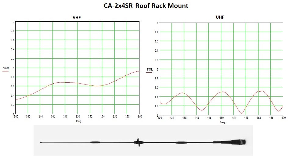

I did an SWR sweep of the Comet CA-2x4SR antenna on my roof rack mount. The link below shows another Comet antenna, similar, to the CA-2x4SR to show what the roof rack mount looks like.
https://forums.mygmrs.com/gallery/image/473-close-up-of-mobile-mount/?context=new
The same test I did with the Diamond NR240CA. The match was surprisingly good considering how little ground plane there was. Compared to the Diamond I think the SWR sweep was just a bit higher over the range, but otherwise very usable. The CA-2x4SR is also significantly cheaper than the Diamond version.
