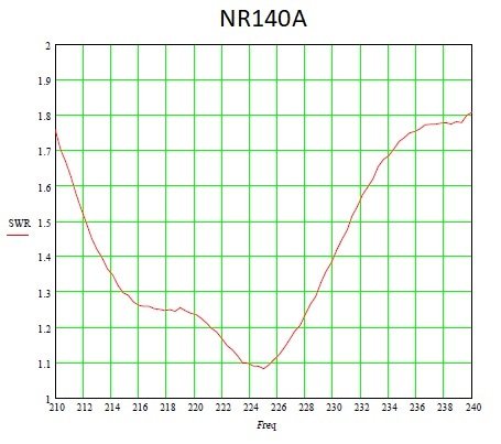

NR140C SWR Sweep
I ran an SWR sweep for this antenna. It's a mono band gain antenna for the Ham 1.25M band. It's about the same size as the Comet CA-2x4SR people claim is resonate on the same band, it's not marketed by Comet for the band. I suspect due to the similar size and some of the design details might explain why this might be the case.
There is no datasheet for the antenna so I had to make one of my own:
