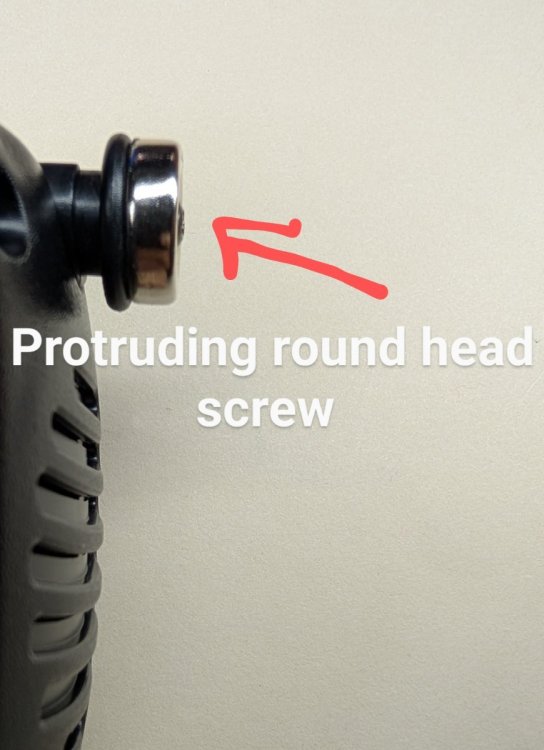

WRNU354 posted a question in Technical Discussion
I bought the Wouxun Mobile Magnet Mic Hanger for my KG-XS20G+ radios thinking it was a good alternative to the included mic hangers. The problem, after installing the Magnet Mic Hanger, its magnet seemed too weak to hold mic securely to a metal surface. In fact, going back to look at the product reviews I found this was the common complaint! However, the problem is not the magnet, but the supplied round head mounting screw. The round head screw doesn't seat deep enough in the magnet's bevelled mounting hole. This prevents the magnet from making full contact with a metal surface. (See first pic) The fix is to either replace the mounting screw with the proper flat head version or bevel the under side of the supplied round head screw so it will seat properly. I chose the latter because its a quick fix using a drill press and jeweler's flat file. (See second pic) Lastly, the before and after vid. PXL_20250429_195511411~3.mp4 -
