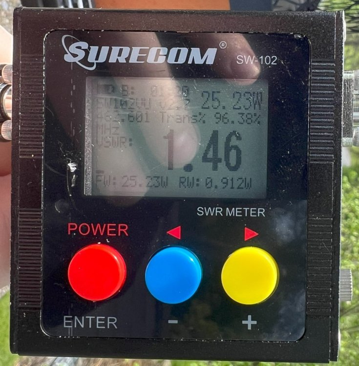

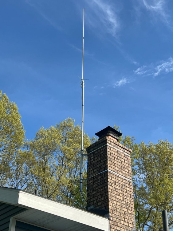

  1. Finally got everything in and some good weather to get up on the roof. Before I tore everything down I went ahead and tested the current setup. Up at the antenna after running through the 10' coax from the radio to the arrester, then from there to the antenna via a 50' coax, my SWR was reading at about 1.46 and wattage indeed cut in half as Steve suggested it might. Read at 25.23W. After running the new M&P (a 9' and a 50') and the new Comet antenna, SWR is about 1.44 and the wattage was 33.0W. Definitely able to hit the repeater I'm trying to get to. Able to hear folks responding to my callout--albeit with static. But I could hear it. I think at this point geography is the limiting factor but I can live with that. Original antenna & coax... New antenna and coax... Antenna mount...
