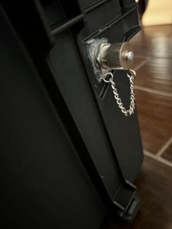

I got the bulkhead connectors on Amazon, bought a few different ones, and just returned the ones that didn't look as good. That is what is good about Amazon is the return process. Thanks for the compliment. -

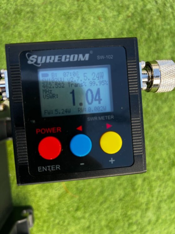

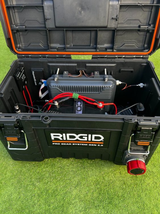

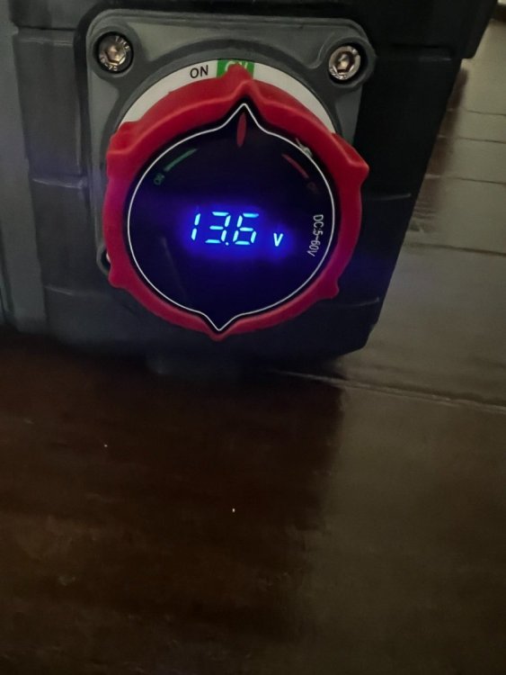

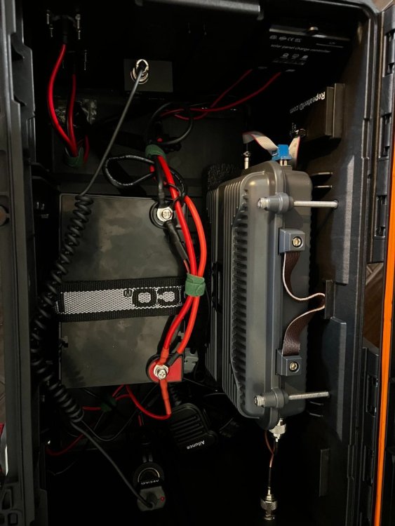

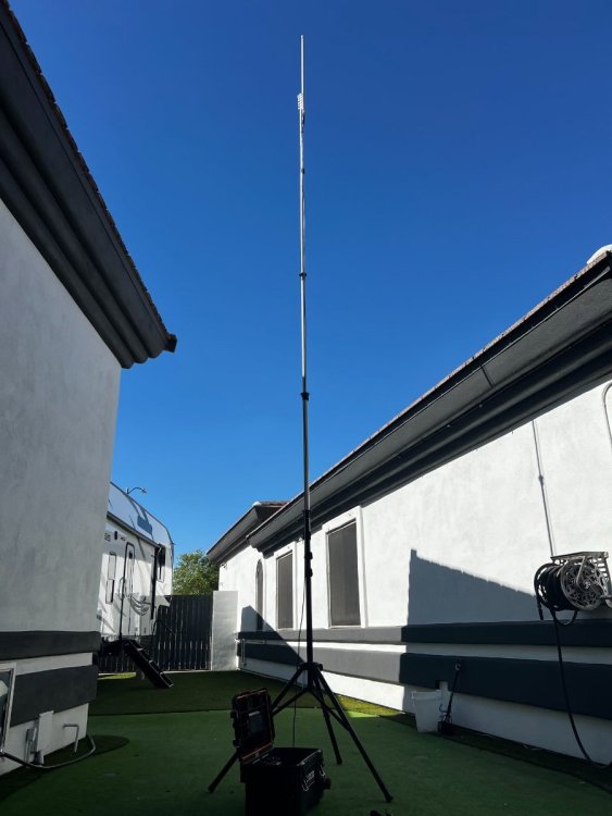

I wanted to share my results of my 2nd Ed Fong GMRS antenna. This is on a 18' MFJ tripod mast on a Retevis RT97 GMRS repeater go box, powered by a 50AH lithium battery charged by tactical solar or wall charger through SAE ports on the box. Also using a repeaterid.com ID system with morse code. Couldn't be more happy with the results, the machine ran all weekend and solar kept it fully charged, and hardly any battery loss over the night. Using the 462.550 / 467.550 repeater pair with TX and RX codes. SWR under 1.1 and getting 5.2W output after the duplexer. The Fong GMRS antenna is the star, so lightweight and portable, with no need for grounding. Using 18' of Messi & Paoloni Ultraflex 7 with the good waterproof connectors (also have a 25' run of it if needed, love this cable and connectors for tactical or shorter runs). If anybody has any questions regarding this set-up, I will be more than happy to help. -
