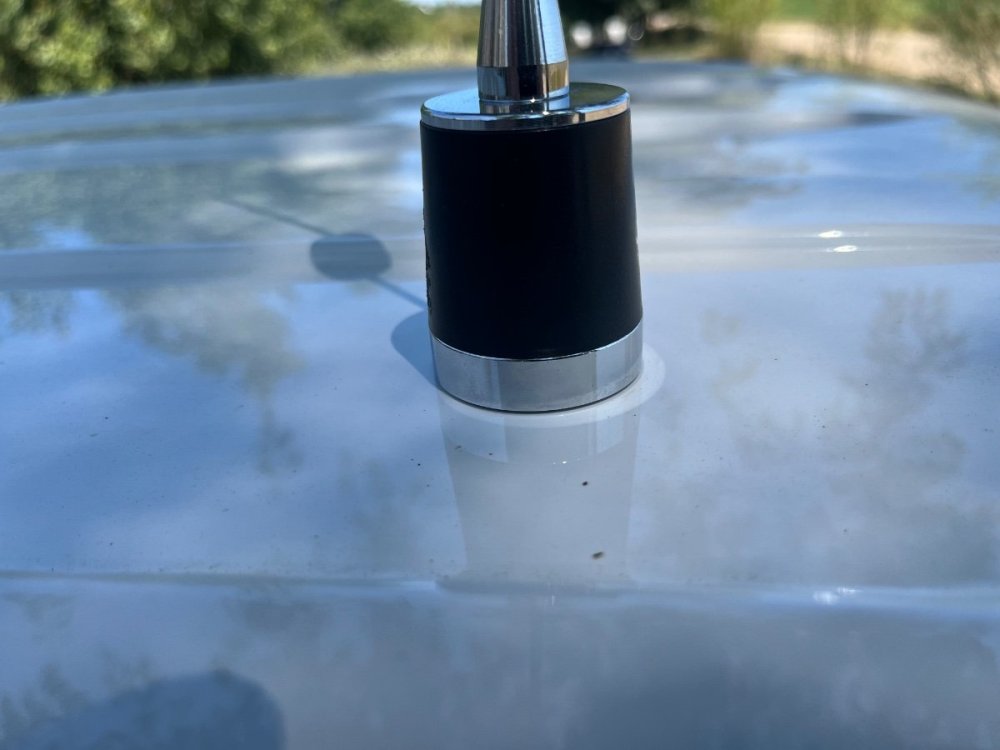

  1. It’s working. Though I’m sure I would get a lot better results with a longer antenna. I wish they made one that could just be swapped out but I couldn’t find any. There are Alan screws holding the actual antenna rod in place. One would think you could just take the short one out and put a long one in and swap as necessary but I’m not seeing them sold individually.

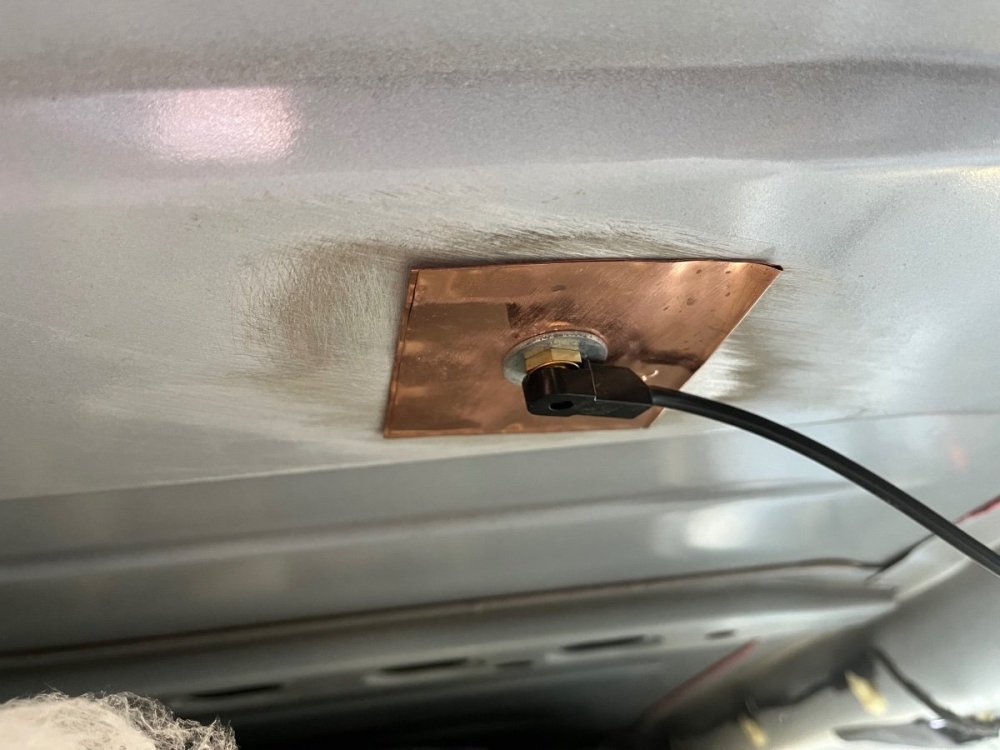

  5. Here’s what I have now. Not pretty but it’s working.

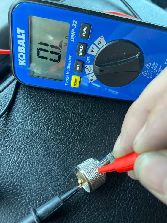

  6. I was going nuclear with sanding probably while you were typing that lol. Seems to be a whole lot better now. Thank you. In the attached pic, is this the proper way to test continuity. Just learning all of this stuff. Thank you for your help.

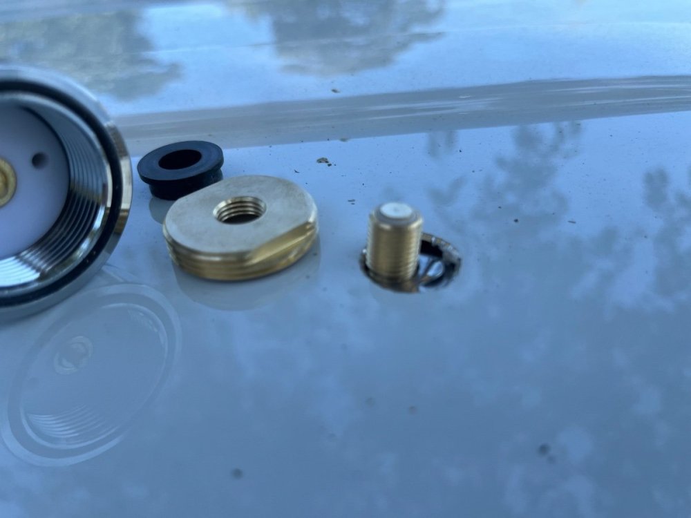

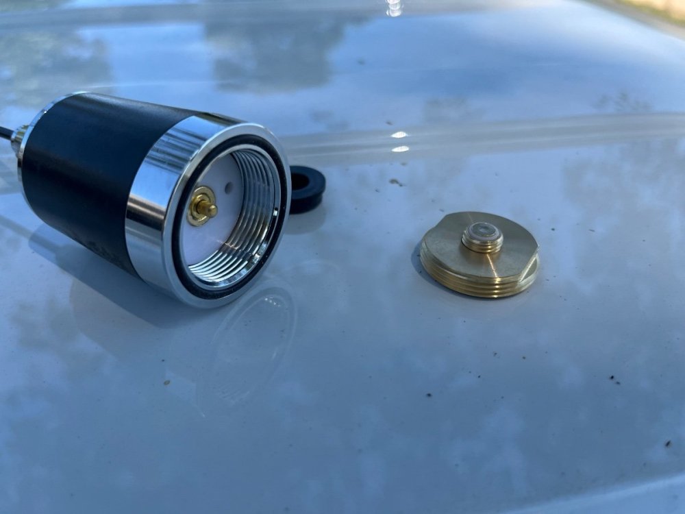

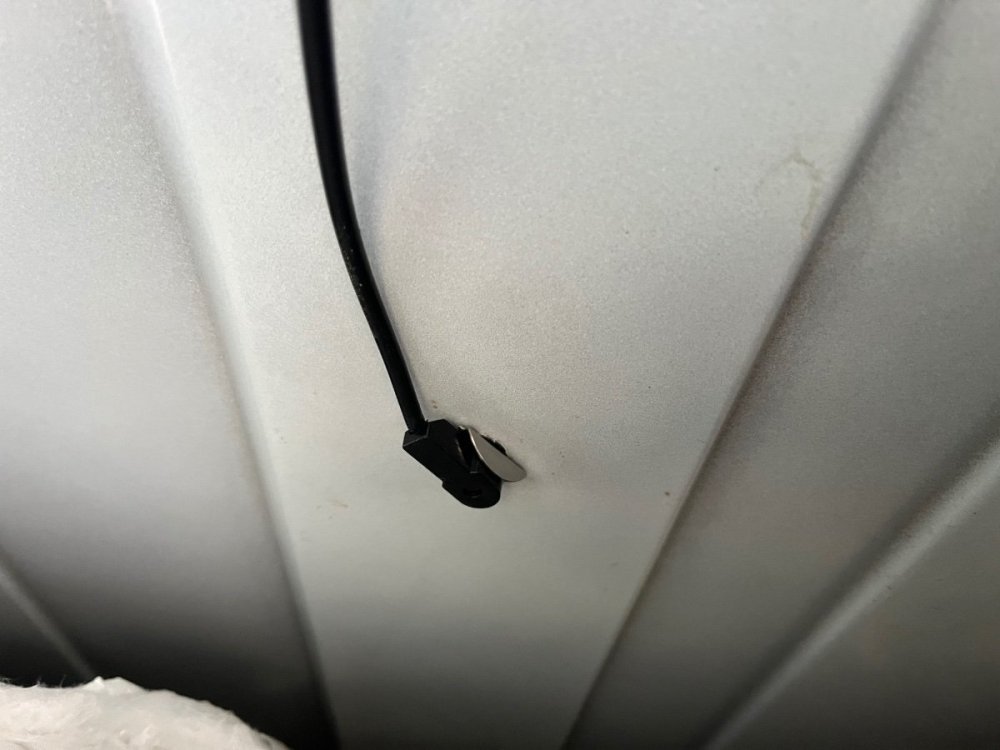

  7. Here is the way it was installed. I’m assuming I wasn’t grounding to the truck body. Seems like maybe I’m missing a washer? That silver washer with teeth, I don’t think that is gonna do the trick. Not sure what it’s for. I will sand and debur around the hole and use a washer this time. thanks
  8. So I did the installation. My reception is terrible. It is super static. I had better reception with the mag mount and get better reception with a baofeng uv5g with stock antenna. Not sure if I did something wrong of something is defective.
