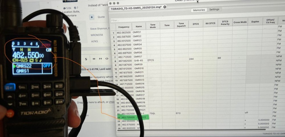

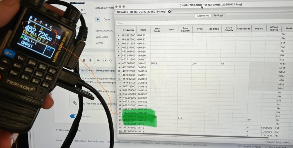

Oh gosh! So I used CHIRP and it programmed the frequencies wrong on the radio! I figured I'd use CHIRP since it's a bit deeper. I attached pictures. I read the radio, inserted a line at slot 22, copied slot 1 (GMRS ch. 1) to empty slot 22. Then I changed the name and added the tone. Wrote back to the radio (I didn't save the image). I noticed I could transmit on 22, but I also noticed that the frequencies didn't go in the way I programmed them. I am on a pretty new version of CHIRP (not the bleeding edge) but not more than 2 weeks old. -
