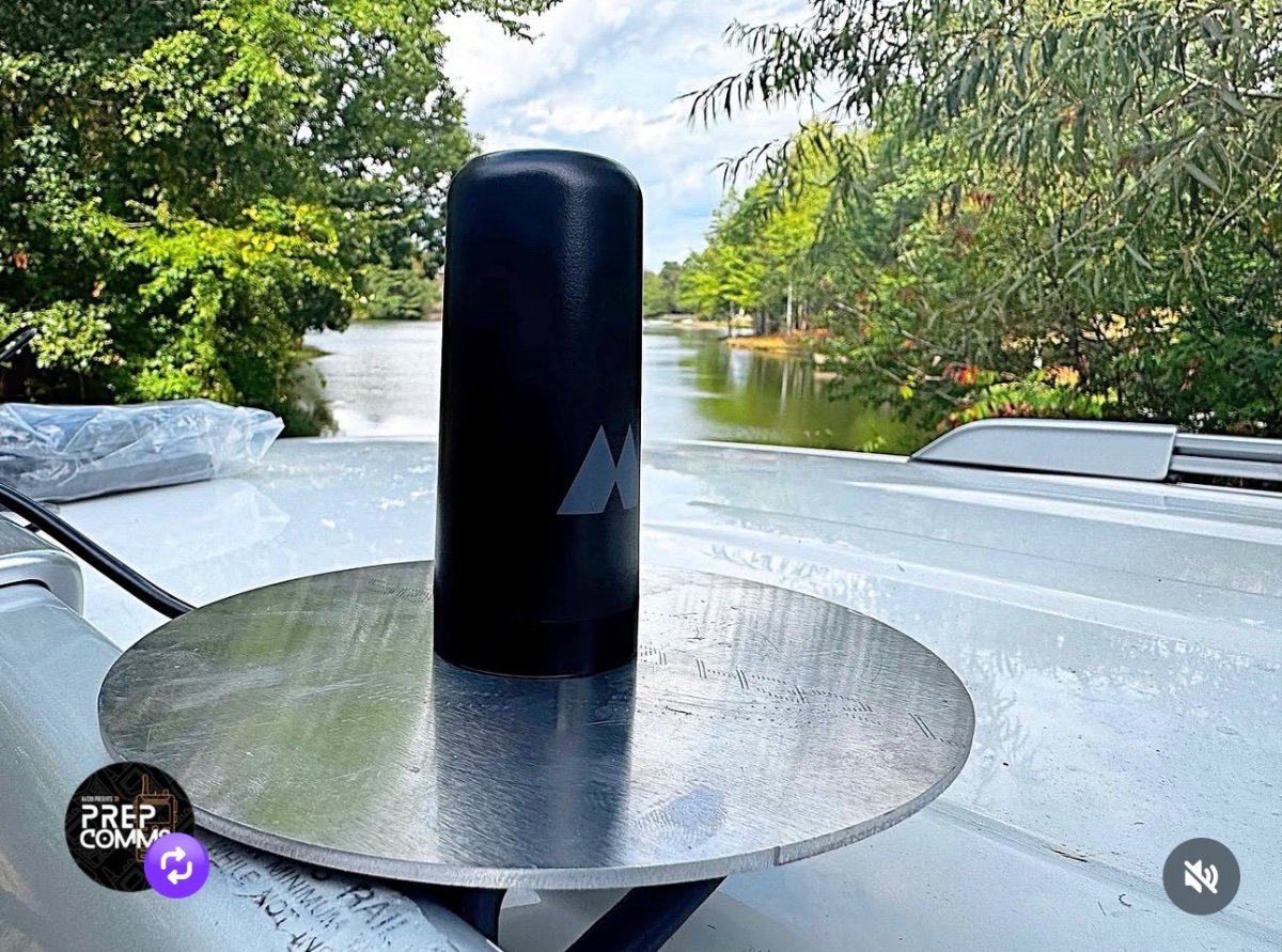

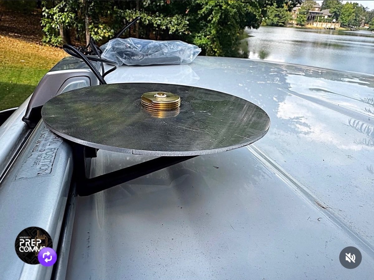

  4. I went with 6” because of where and how I mounted the antenna. A full 12” would be ideal but it would have extended out and overhung the side of my 4Runner - which was not desirable. I’m working on a new set of cross rails and I’ve designed them to accommodate a full 12” mounted along the centerline of the vehicle.

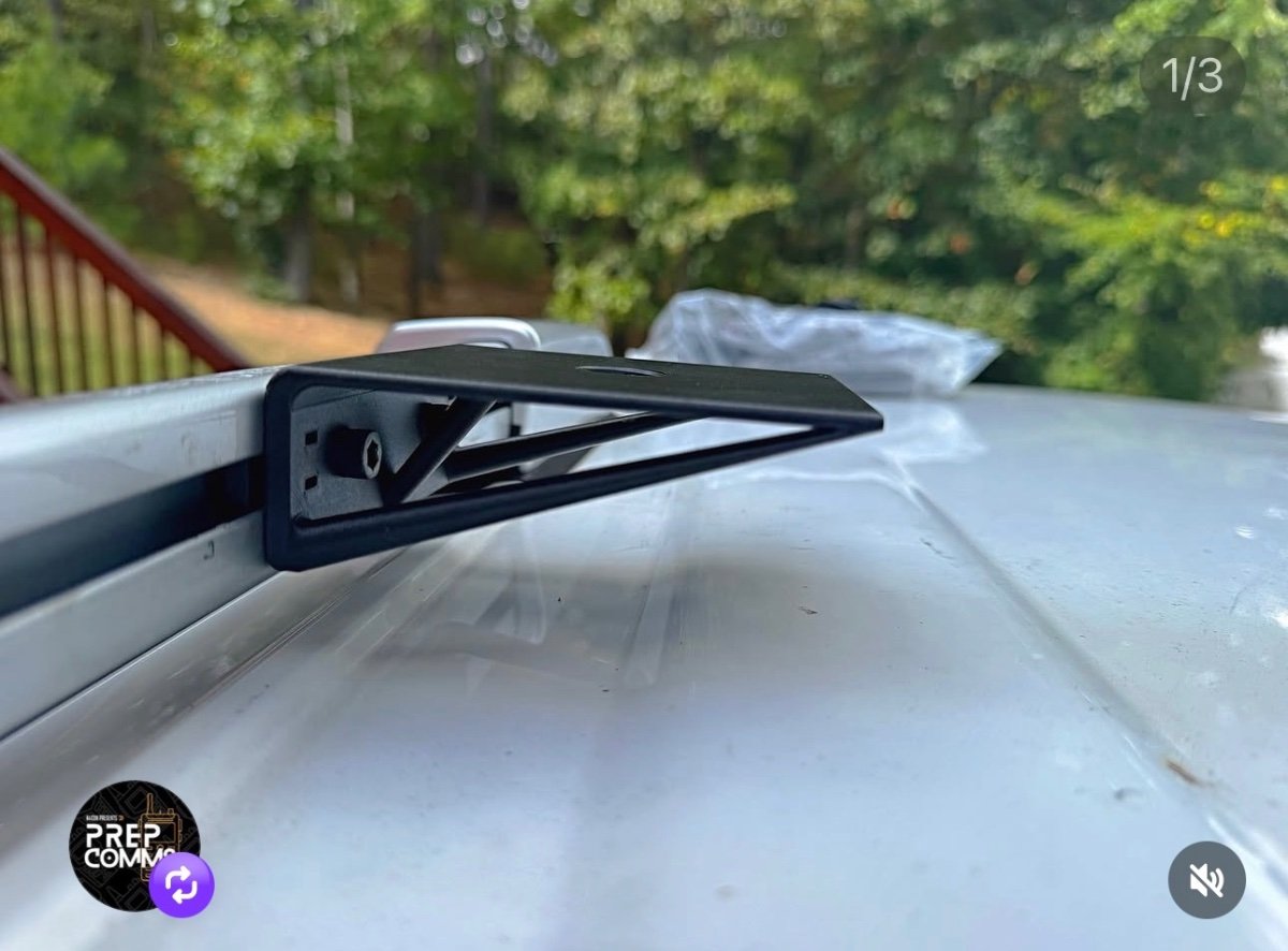

  8. This is what I did for mounting the antenna on my roof rails and added the 6” diameter 5052 aluminum disc for a ground plane. No significant wind noise either. The base is printed from PETG-CF.
