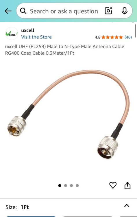

  1. Ok that’s what I was hoping. The size doesn’t matter too much on such a short wire. I was going to get some rg400 and connectors from DX Engineering and crimp / solder it. But these Uxcell pre-made jumper cables are very tempting at $15 each. Seems like good reviews. I’m probably going to try them. I’ll check it with my SWR meter. But I’m not sure the SWR meter will tell me how good or bad they are?
