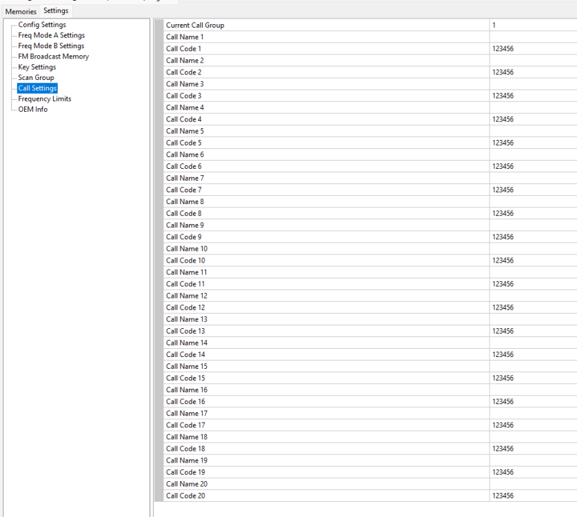

  3. Hello everyone, I’m running into a consistent programming issue with my Wouxun KG-935G Plus using CHIRP. Here’s what’s happening: I program my repeater channels with: Correct RX frequency (e.g. 462.xxx MHz) Tone Mode: Tone Tone and Tone Squelch matching (e.g. both 131.8 Hz) Duplex set to “+” for standard GMRS repeater +5 MHz offset Problem: After saving and reopening the file: Tone Squelch reverts to 88.5 Hz on all channels, even though I set a different CTCSS. Duplex changes to “split” and TX Offset shows random frequencies like 930.1 MHz, instead of standard +5 MHz. I’ve tried: Re-entering and saving multiple times Clicking another field to lock before saving Using the latest CHIRP daily build (if compatible) Confirming the radio model and cable are correct Question: Has anyone else experienced this issue with the KG-935G Plus or similar models in CHIRP? Is there a known fix or workaround to retain Tone Squelch and Duplex settings correctly? I want to ensure my repeater channels are reliable for daily and emergency comms. Any insights would be appreciated. Thank you in advance.
