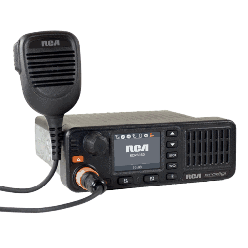

  1. Has anyone had any dealings with , or know a software source for the RCA RDR6350U. https://www.rcacommunicationssystems.com/wp-content/uploads/2020/06/RCA-ProDigi-RDR6350-Brochure_web_20200527.pdf I have (the UHF version) and a program cable, but have exhausted myself looking for programming software. Wont go into all the details, but RCA won't help, & so far the authorized dealers, who are willing to help, only want me to ship the radio in to them for costly programming. I did find a place (web page) who looks like they have the software to sell/ share but want $155.00 a year subscription, and looks kind of sketchy . One source says I need this software : CPS RDR43x0-RDR6350 I found a page on a forum that said the radio may be compatible with the Motorola "CPS" software. But don't guess it would be. Though RCA claims that these radios are fully compatible with Motorola radios. RCA has discontinued this radio , but still manufactures other two way radios. https://www.rcacommunicationssystems.com/ Anyway, seems like it might make a nice GMRS radio & hate for it to go to waist, ideas ? thanks Mike , WRMS528 / KX4MIK ( i am good on QRZ )
