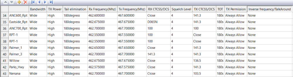

  2. OffRoaderX, I appreciate you taking the time to do testing on these radios. There is a Tail Elimination setting when configuring channels in the programming software. I posted snip of the channel programming screen to SteveShannon. The default setting is 180 degrees. The is also a 120 degrees and a none setting. I believe the default his best setting. However, it does seem eliminate the Tail. Just got a message from Support. They are wanting me to send the codeplug (configuration) for my radio. Seems like they want to help. We'll see. Take care
  3. WRPX381, Just tried it. Set to 8, still getting the noise burst
  4. Here's a screen shot showing the Channel Config. The Tail Elimination can be set to 180 degrees, 120 degrees, or none. Default is 180. I tried 120 and None, seemed to make no difference.

  7. Anyone have experience with the Ailunce HA1G? It is sold by Retevis. Having an issue with one I recently purchased. The features looked great. They seem to be solidly built and are suppose to be waterproof. There are 220 channels available for custom configurations. So, I though I would check them out. While setting up and testing two HA1G's a experienced a perculiar problem. When I would receive a transmission from a repeater I would receive a loud noise burst on the HA1G when the transmission end. It was very annoying to say the least. I test this with with an Anytone D878UVII Pro hand held in simpex mode. Same thing happens. I don't noise bursts on the Anytone only on the HA1G. After contacting Retevis support I was asked to do several tests. During those tests I found several interesting things. Setting the HA1G to use Digital Tone Squelch seemed to stop the noise burst. Of course, this doesn't really solve the problem. Since you would need every repeater you work would have to transmit a DCS tone that you have programmed in the HA1G. I find many GMRS repeaters don't transmitt any tone squelch codes at all. So, that leaves you to working only repeaters that have a DCS tone transmitted. I also found that tranmissions between the two HA1G do not experience the noise burst. Go figure!. I would be interested in any feedback on this subject. I would hesitate to recommend this radio until I can get a good answer for the issue.

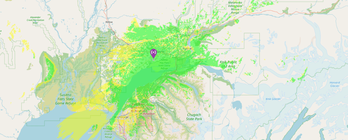

  10. Just got a new Retevis RT97 up and running in East Anchorage. Location is near Boniface and Reflection Dr. Using 3 element Yagi pointed south from my Condo balcony. Transmissions to the west are mostly blocked. Hopefully, this will work most of East Anchorage and possibly toward Eagle River if mobile or base is used. Best reception should be good on the Hill Side. Will need testing to see what the actual coverage is? The initial tone setting is 141.3 for input/output. At some point I plan to change to a DCS Tone. Please be mindful of other users of the frequency. All GMRS frequencies are used on a shared basis. No one owns any particular frequency. So, before you transmit to access the repeater determine the frequency is not already in use. If you use Tone Squelch you may not hear other uses of the frequency. In order to determine if the frequency is clear you will need to open your squelch in some way. Use your Monitor feature if your radio has it or use another channel on your radio that has carrier squelch. If possible, just set your repeater channel to use carrier squelch instead of tone squelch. Also, remember you are required by FCC regulations to use your FCC issued GMRS call sign when you are finished with a conversation. There's no need to repeat your call sign after every transmission. If you are in a long conversation, you must repeat your call sign every 15 minutes. However, let's not tie up a repeater for that length of time. Others may be waiting to use the repeater. Try using a simplex channel, if you are close enough to the other station, to continue a conversation. If you have an urgent need or emergency you may break into a conversation by saying "break, break, break". Others on the channel should yield to you. If you would like to join a conversation just you drop you call sign during a break in the ongoing conversation. Let's keep all conversations family friendly. And above all be courteous. One last thing. If you are running a business don't use this repeater (to run your business). There are licensed frequencies available specifically for businesses. You can obtain a frequency that is not shared by others. There are other license free frequencies available on a shared basis in the MURS or Multi-Use Radio Service. These fall under Part 95 rules but are not likely to be used by the general public. If you are not familiar with the rules governing the GMRS please refer to FCC Part 95 subpart A. CFR-2009-title47-vol5-part95.pdf (govinfo.gov)
