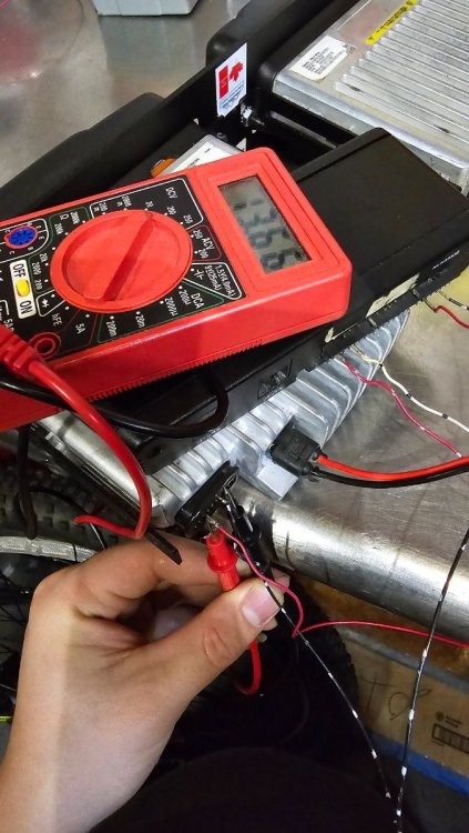

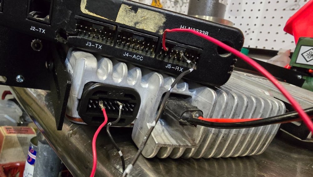

So I got some jumpers and got 13v out of pin 13 and pin 7 as ground (radio is upside down). I mirrored it to the RICK as the connectors would be and I'm still not having the rick power up.

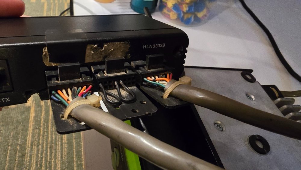

Welp I gave that a try with pin 7 being my ground and pin 13 being +12v. And both radios were giving 13.2v. I'm suspecting that it may be my patch cables. If it is, I'll feel really stupid. I'm going to just order new connectors and rewire the patch myself in hopes that my problem. Ive douted it being them since it worked with my GM300's and these are 16pin fully populated. sorry to be a inconvenience.

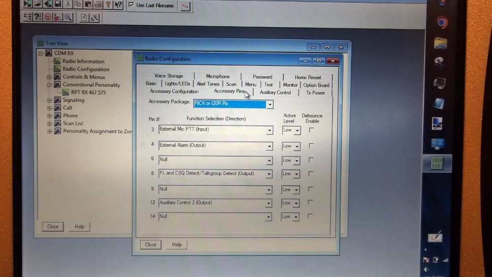

Hello and thank you for helping. Yes I've been using the power switch to try and get power onto it. The patch cables have all 16 pins populated for both radio and rick ends. I've adjusted the programming to what you have noted. The TX radio the COR is now null and on RX radio pin 3 is now also null. Thanks for that insight. I've also opened the rick and my dip switches are set to what the manual worksheet has for my needs. Even with all this, I'm still not getting power sent to the Rick. So I'm stumped again. Could it be possible that there are jumpers in the CDM's that I'm missing? I've opened one up and didn't see any.

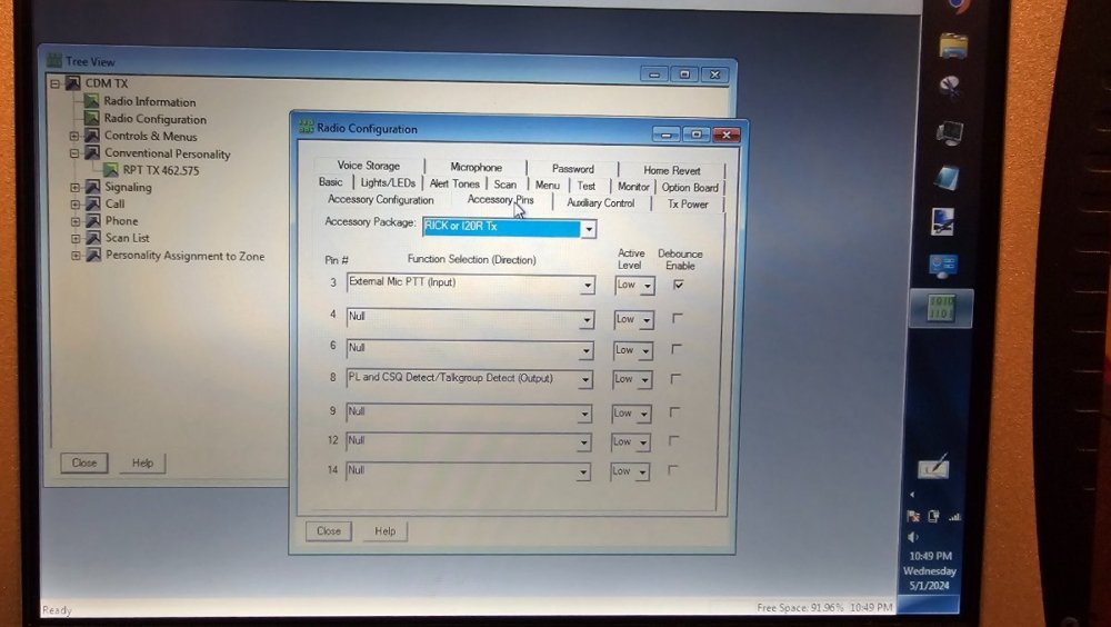

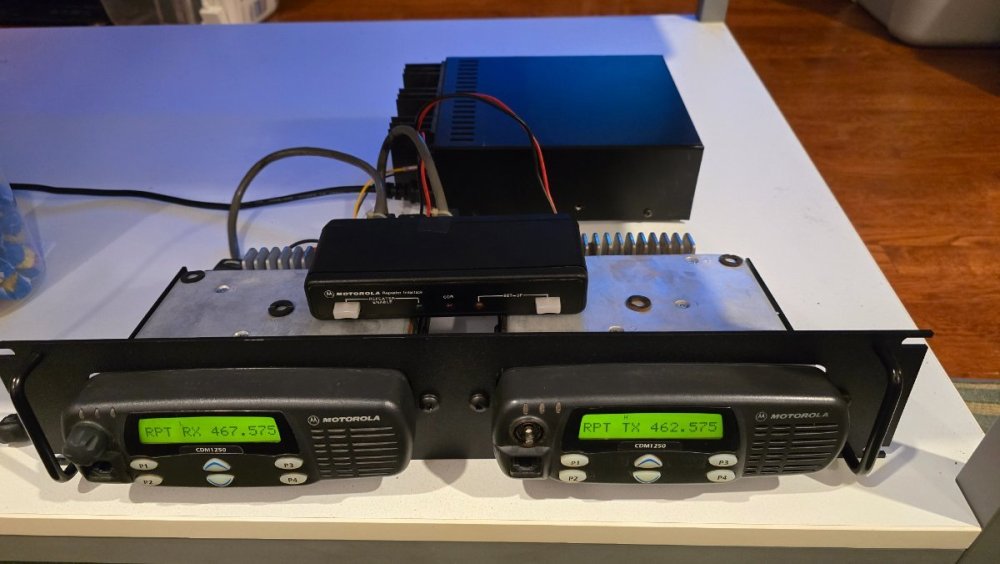

Hello Internet. I'm trying to use 2 Motorola CDM1250 radios for a repeater configuration with a motorola RICK, and I'm having a difficult time trying to get the cables from the CDMs to power and control the Rick. I know the rick and cables work because they came out of my working GR300, but they won't now. I'm confident it's some settings in the CPS but I've played around with it extensively and I've became exasperated. There's some magic setting I'm missing. Does anyone have an idea? **Pin 4 and Pin 12 on the RX radio is set because I want to use the RICKs knockdown feature where if I transmit a DTMF tone, it'll kill the TX repeater with ignition sense.
