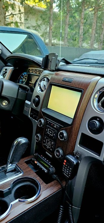

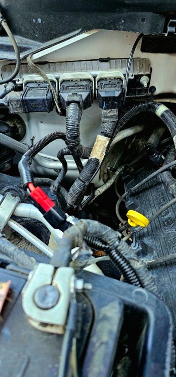

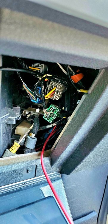

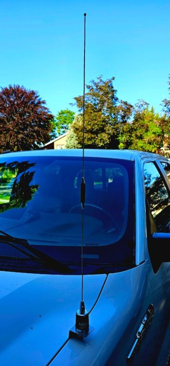

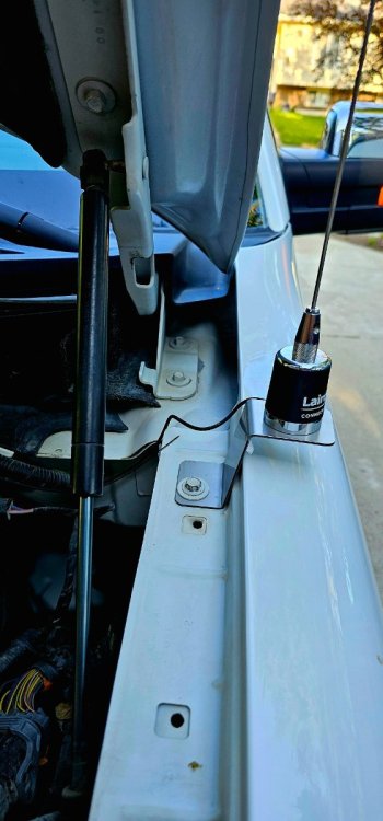

dosw Posted Tuesday at 02:54 PM Report Posted Tuesday at 02:54 PM As I've posted previously, I have a Wouxun KG-UV980P, which is physically identical to the KG-1000G but with different configuration (one is ham, the other is GMRS). This post also covers installation of a KG-1000G Plus, since its hardware is substantially similar. I've been using the KG-UV980P for a couple weeks loosely installed (wires connected but nothing routed or bracketed in) to test it out. I started down the path of installing it myself, but in the end decided to go with a professional installation since the interior of my truck is too clean for amateurish work, which I would certainly achieve. My vehicle is a 2014 F150 Lariat Super Crew 6.2L v8 6.5' bed. The center console is pretty packed, but there was one area near the bottom that seemed like a possible fit for the radio's faceplate. A nice feature of the KG-UV980P, KG-UV950P, KG-1000G, and KG-1000G Plus is that they have a detachable, remote faceplate. You can install the face plate on the radio, or remotely, where it must be fed with a wire that looks like (but isn't) a Cat-6 cable. This allows for cleaner installation options. Here's a big thanks to Innovative Audio in Sandy, UT, who performed the installation better than I had asked for. It wasn't cheap, but they did great work. The equipment: KG-UV980P. Diamond stainless antenna mount for 2009-2014 F150. Diamond low profile NMO connector with integrated cable. Laird TE B4505CN antenna (no ground plane required). This is a 5dBi gain antenna designed to work in no-ground-plane or poor-ground-plane applications. And some custom brackets that Innovative came up with. I also have a dual-band UHF/VHF no-ground-plane antenna that I swap in for 2m/70cm use (Diamond NR770HBNMO). Pictures attached. You'll see the faceplate mounted at the base of the center console. The base unit is mounted behind the glove box amid a rat's nest of other stuff. I have no idea how they got it in there. In one picture you can almost see the PL259 connector. I asked them to leave the data cable attached, which they did, and it is routed into the glove box. The antenna cable and power cable are routed nicely through the firewall together. And Anderson connectors are found inline between the battery and the radio's power cable so that I can disconnect it easily. The mic is mounted adjacent to the face plate. Despite the radio being installed behind the glove box, I can still hear its speakers very well. But additionally, this radio's mic has a built-in speaker. I have both set to work simultaneously, and the sound quality is just fine. Pictures below.... 1cI1Cuc82OIORIht0KruyUfotMt1kqC1I 1cLFpEks6_8DufPIbSFfuGwKOO11HDnoX 1caXVXEhv35By5zxZhs2UqwlHCUbx9_dK 1cadyxIWJrQNf8rf3bExVYhzRID5-1NyG 1cbh71eF_FLX1_D4v4IcoMmvyvufTHAJb 1cgTii_W1wld9AT7flXwwz7DYh5Vdmluw 1cGr3mvQB-ZRAhteXc_-nAsVcs0fZzIud 1cHj38upff9q-yR4LPVuWSEoLViG8STiv 1d-wlBEY01CxzogRPtfn0XIZ2bs5ld8FQ 1d5SM3-n9paG2-63xu0Drj7gh7UCxwWA7 1d-JS6oOMGi5bFvcuDi1bns29dcuCeqgy Socalgmrs 1 Quote
