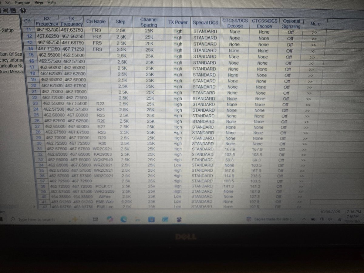

GMRS channel 20, config as above. Channel mode running a Ed Fong J-pole 35' in the air with 50' of LMR 400. HT is a Tidradio H-3 in GMRS channel mode.
Program for DB20-G in channel 22 for a repeater that's 5 miles away is 467.7250 TX / 462.7250 RX with Encode input only.

CPS file. I don't get a thunk when I release the PTT.
Try clearing out the Decode values, at least at first. If they’re wrong you’ll never hear anything from the repeater, even if you’re getting in.  That will also allow you to hear if anyone else is transmitting on the same frequency or if the repeater IDs itself.
Second, not all repeaters kerchunk. The lack of a kerchunk is not necessarily a reliable way to determine that you are not hitting a repeater. However, if you get a kerchunk it’s certain that you got into something.
Finally, which channel are you trying?
Thanks for the info. I have tried all of the repeater channels and some I can hear. In two months I can't transmit/ radio check. I also went with the decode blank, no joy.
One thing at a time. Having the decode blank doesn’t allow you to transmit.  It’s strictly done to allow you to find a channel that has traffic.  With decode cleared on your end, you will receive any transmissions made on that channel regardless of how they are encoding.
Once you have found a channel with traffic then you need to set encode correctly so they can hear you. If you don’t set the correct encoding, whether CTCSS tone or DCS code, they will never hear you.
You said you heard chatter on Repeater channel 29.  That’s a good first step.  However, in the photo of your screen you don’t have any encode tones set for channel 29 so they cannot hear you.  Figure out what tone or code the repeater requires and add it to your channel 29. Then ask for a radio check.
