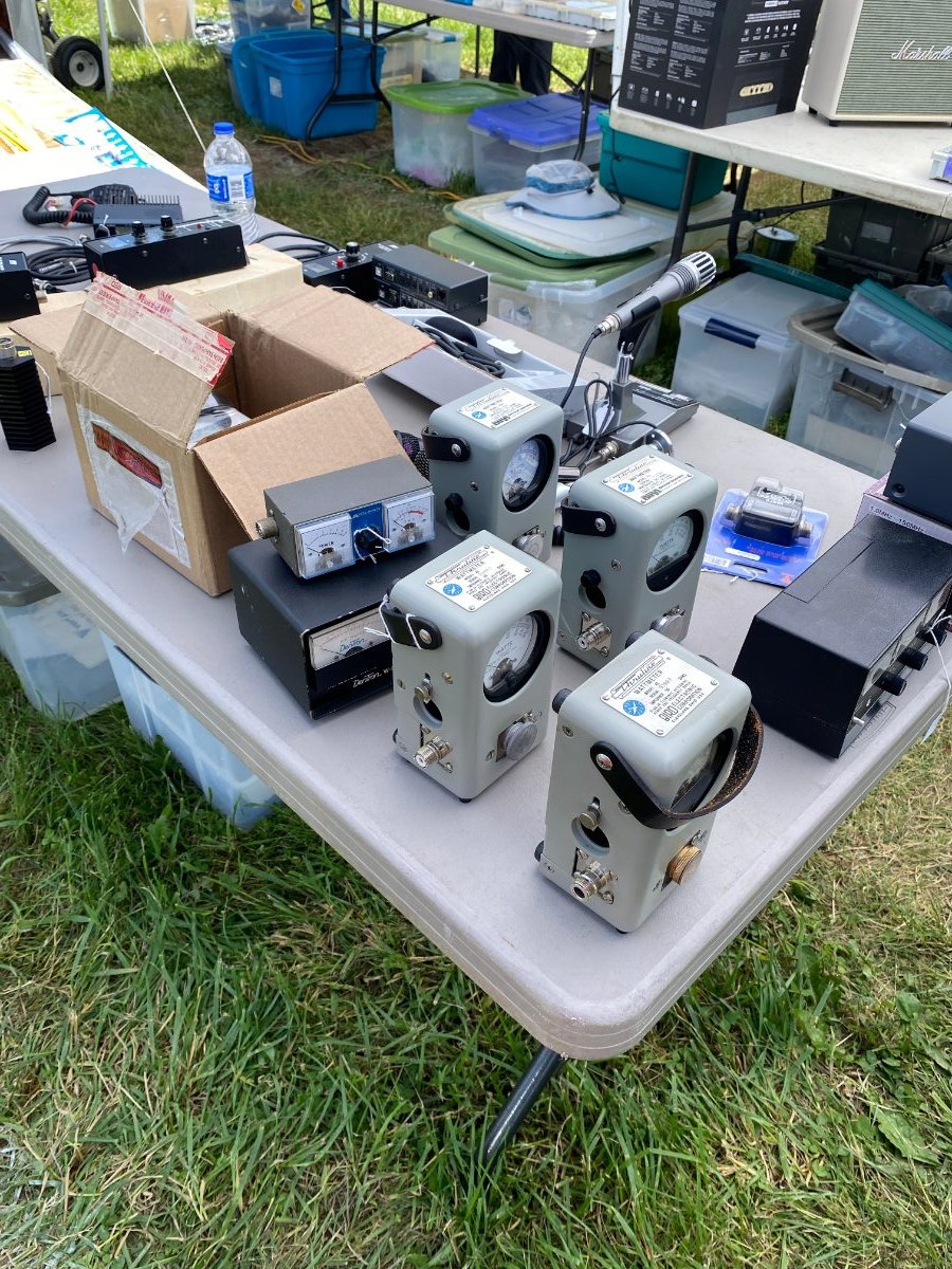

Lscott Posted November 17, 2025 Posted November 17, 2025 23 hours ago, WSAQ296 said: I'll wait for the right person to come along, if I sell/give it to the wrong person they become a pain in my side. Yup, then they'll look to you for help to design, build, install and help maintain it! I know a guy right now who has a Ham UHF repeater. He's too cheap to buy a quality Bird wattmeter to monitor the system and use it for checking the match on the antenna. I saw several at the Dayton Hamvention last year for a decent price. He said they were "too expensive" and wasn't sure they fit his requirements. He might spend money on some new hard-line, and a better antenna, but not for test gear. gortex2 1 Quote
