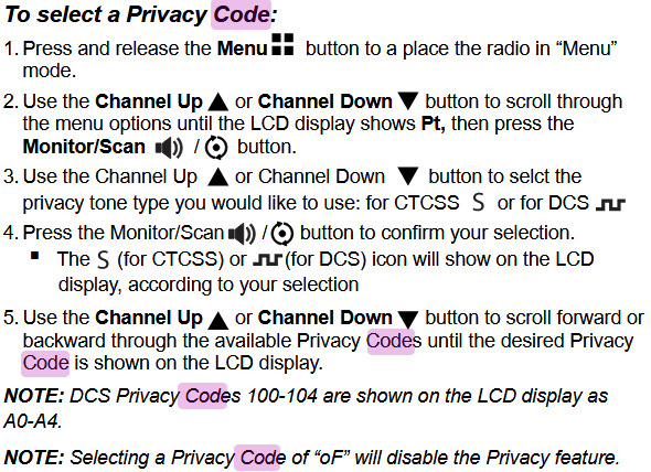

From your video, if definitely looks like you are getting into the repeater. It is my understanding that on the MXT115 when you program in the tone, it assigns it to both RX and TX. It looks like, as @GreggInFL said, your receive tone is incorrect. Or rather, it is different than the one the receiver is using. This could be down to one of two things. The receiver doesn't have a tone set at all, or it has a different tone set than you have on your radio. Since the MTX115 can't do split tones, the simplest - and only way, I think - to fix the issue is to turn off the receive tone on your radio. A quick consult with Gemini says to do the following:
Steps to Remove Receive Tone on MXT115:
  1. Select Channel: Choose the desired repeater channel (e.g., 15RP–22RP).
  2. Enter Menu: Press the Menu button.
  3. Navigate to Receive Tone: Use the channel up/down buttons on the microphone to scroll until the display shows "rC" (Receive Code).
  4. Select Setting: Press the Scan/Monitor button to select "rC".
  5. Turn Off: Scroll through the options using the mic buttons until you see "oF" (Off).
  6. Confirm: Press the Scan/Monitor button to save the setting, or wait for the menu to time out.
This will let all traffic from that frequency come in, even if the repeater is operating with split tones.

The phrase "Receive Code" doesn't exist at all in the very easy to look up manual. Near as I can tell, on the MTX115, there is in fact no way to set Tx and Rx tones separately. You either have "Privacy Codes" On, or Off for a channel.
Page 19. Or, according to Gemini, Chapter 47 verse 2:
https://files.bbystatic.com/qdiFGyGKsdiXkkryejvQGg%3D%3D/01bdaec9-d938-4a04-9c49-1d6383686f40.pdf

Thanks for correcting me. I don't normally trust AI, but this seemed rather straightforward and good enough to go with it at the starting point. Looks like I was wrong.
