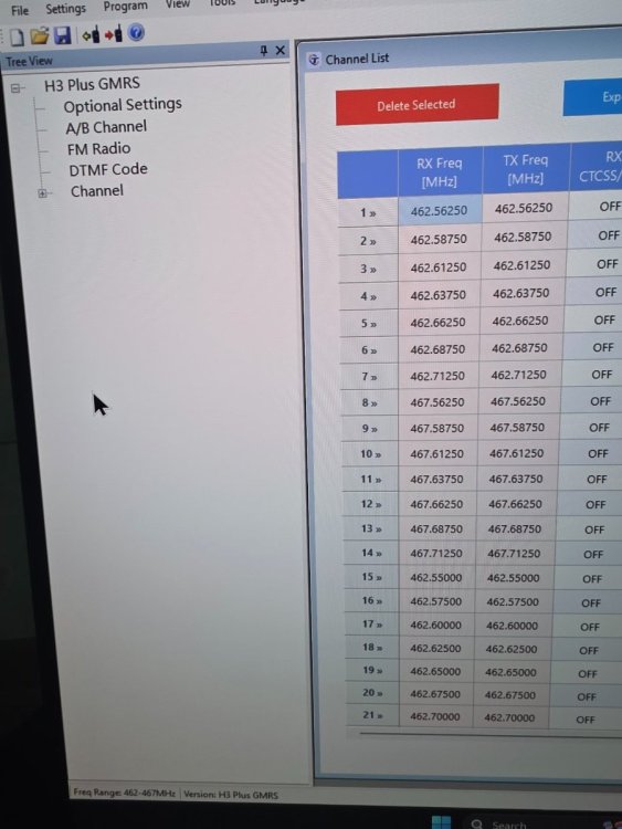

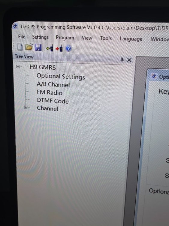

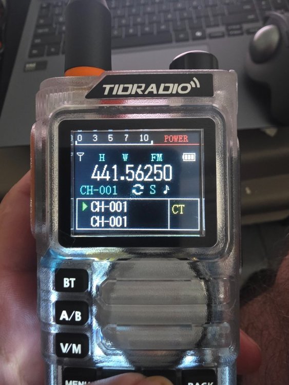

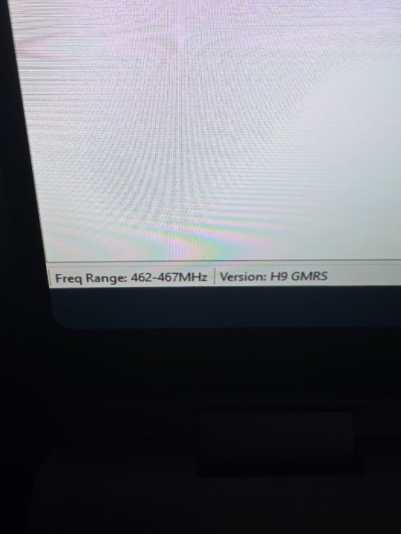

Here's a picture of the actual package I purchased, the CPS showing the gmrs channels, and a couple pictures from the radio.  These frequencies aren't even PMR like I got a European model. The radio screen also looks like it has ctss codes preprogrammed.
Here's my 3rd edit.  You can also see that the CPS they supply is for an H3.  I might need to look at the settings for that. That could be on me. Either way it says if you're Kenwood style cable won't program the radio to use the app or USB c. Neither work.

When I do put it in vfo mode and use a gmrs channel with a gmrs antenna there is an annoying high pitched tone in the background.
I've gotten update. I was able to download a CST file, switch to normal mode and program all the gmrs frequencies. I tested the first six channels against my Rocky Talkie expedition radio and it worked fine.
