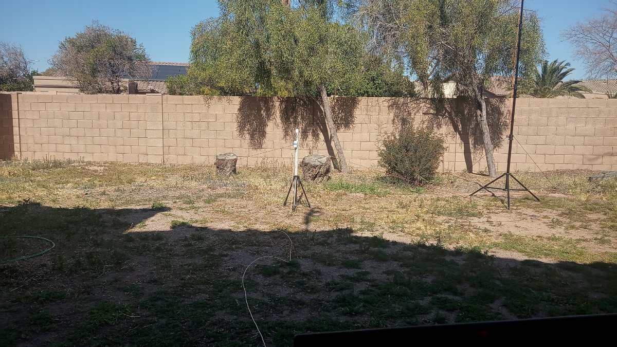

TNFrank Posted February 3 Author Posted February 3 So far I have 12 Countries logged on QRZ. Of course 2 of those are Alaska and Hawaii but still, this little QT80 Mobile is working great as a Base Station. I set my Inverted V up about 3 feet above the ground and tuned it to 1.4:1 SWR to see if I could get it to work as a NVIS for closer contacts. There's a lot of POTA Stations that are too close to hit with the EFHW so hopefully this will do the trick. Quote
TNFrank Posted February 3 Author Posted February 3 Tested the Inverted V at 3 feet and still can't hear California. I wish I could find a solution to Short Range 10M HF. Quote
TNFrank Posted February 3 Author Posted February 3 Just when I thought the Inverted V at 3 feet wasn't working I got a POTA about 3 miles away here in AZ. Davichko5650 1 Quote
SteveShannon Posted February 3 Posted February 3 14 minutes ago, TNFrank said: Tested the Inverted V at 3 feet and still can't hear California. I wish I could find a solution to Short Range 10M HF. I’m not certain such a thing exists. It’s too high of a frequency to reliably NVIS. 80 and 40 meters are the frequencies where you can eliminate the gap between local and distant communications. Quote

tweiss3 Posted February 3 Posted February 3 41 minutes ago, TNFrank said: Just when I thought the Inverted V at 3 feet wasn't working I got a POTA about 3 miles away here in AZ. That is ground wave, not NVIS. 56 minutes ago, TNFrank said: Tested the Inverted V at 3 feet and still can't hear California. I wish I could find a solution to Short Range 10M HF. NVIS at 10m is almost non-existent. You need the right atmospheric conditions. SteveShannon and TNFrank 2 Quote
