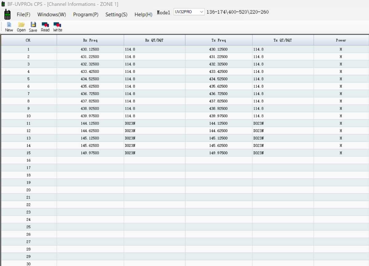

There is a four way rocker switch on the front of the radio.  At top and bottom it has an up arrow and a down arrow.  At the sides it is marked P1 and P2.  Everything on the net claims these are programable.  YouTube reviewers are shown programming them.  However.......   I downloaded the CPS from Beaufeng for the UV-32 and my software is different.  There is nothing that deals with P1 and P2.  At present they do nothing.  Just wondering if anybody had worked through this Beaufeng SNAFU or no.  Obviously not end of the world situation here but I can think of things that would be nice programmed on those keys.

im not at my program computer but i seem to remember that parameter can be programed under the radio function tab..  I'll check that this evening .
This is what my screen looks like.  I have no options to the left of the main window.  The functions screen is the same with no navigation segment to the left.

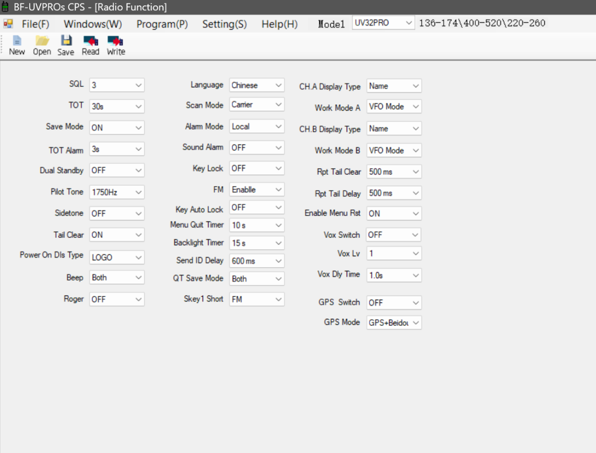

O.K..  I was able to remote into my computer.   You can program P1 P2 under Key Function (left menu), you'll see the options down towards the bottom of the Key Setting pop up.  Hope that helps
I very much appreciate you going to all the trouble of remoting in.  This is what my functions screen looks like.  Nothing to the left.

I have the UV32. I use chirp and select UV21progps. In the settings tab you will find the key function options.
I did just find a use for P1 and P2.   When GPS is enabled pressing P1 will show current position and P2 will show a drawing of a compass.  This is the default of the radio.

I want to thank you again for looking this up.  Maybe something changed in the model or the software but there is still no options to program P1 and P2.  That's ok.  I like the way they work with the GPS function.  I'll be happy just using it like it is.  I think at this point it's more work than it's worth.
No I just looked again. I thought you were referring to the side keys 1&2. Sorry to get your hopes up.
