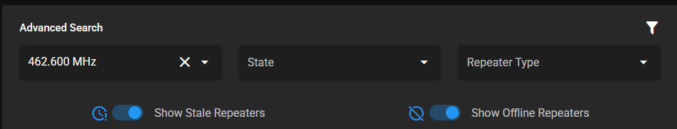

amaff Posted Tuesday at 05:46 PM Posted Tuesday at 05:46 PM 2 hours ago, SteveShannon said: At the top of this page is a menu choice that says Repeaters. Click on it and look up the repeaters for your area. Or introduce yourself to us and tell us where you want to use a repeater and someone will probably help. This. There's almost 600 repeaters listed, plus who knows how many that aren't on MyGMRS, just on 462.600. You'll need to narrow it down a bit ... Quote

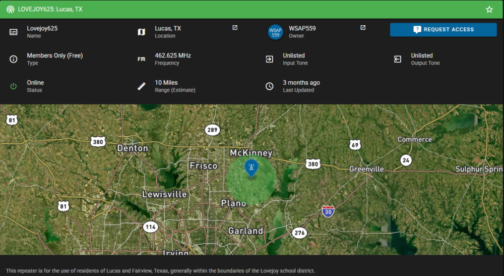

amaff Posted Tuesday at 06:13 PM Posted Tuesday at 06:13 PM 16 minutes ago, oldpenguine said: I live in Plano Texas a suburb of Dallas. I looked in repeaterbook.com but could not find anything for 462.600. I searched GMRS repeaters and found volumes of information but cannot find anything about what tones to use. I feel like a lost dog in a snowstorm. Walking for hours and winding up in the same spot. Thank you all for any help you can provide. Is there a specific repeater you're trying to access on .600? Usually it's pretty straight forward. Sometimes the information is published plainly (generally, "open" repeaters), other times they ask that you request access and they'll send you the details. The only one I'm seeing near Plano that MIGHT work (it's a ways away) is this one, on 625. Looks like you can request access for the info. "Open" repeaters will usually have info like this: Quote
amaff Posted Tuesday at 06:33 PM Posted Tuesday at 06:33 PM I guess my question is, how did you arrive at 462.600? Is there a repeater out there that you're hearing on that frequency? If so, it may just not be listed (at least, not on MyGMRS). Your radio may have a tone scanner function that you can use to listen for the output tone, and hope that it's using the same tone for both input and output (but we won't know without knowing what radio you've got). But given that I'm not seeing anything on here near you on that frequency, or on RepeaterBook, that may be your answer as to whether or not they want random people hopping on. Quote
