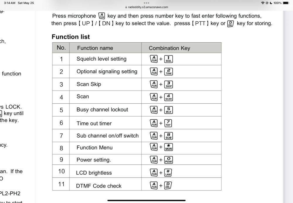

Hey all, been asking lots of questions, again for the Radioditty DB20. There a way the sub channel gets muted when the main channel is getting used, I can’t seem to find the setting or figure out how to.
Turn it off. Fun + 8, unless they have a typo.
