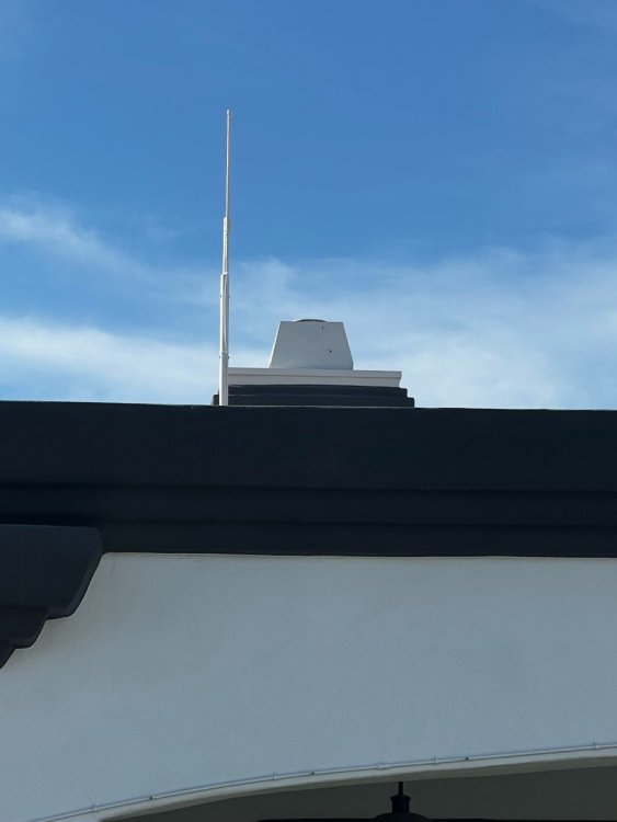

WSBR383 Posted June 4, 2024 Author Report Posted June 4, 2024 WRXP381, I am sure the Comet 712 is better, but again, in an HOA, they don't allow you to have a 10.4' antenna above the roof-line. If I had no restrictions, I would choose a different antenna. I actually have a comet SB 790a for 2m and 70CM and love it, it was the biggest I could go and still be allowed in my HOA. Please keep review in context, I am not saying these are the "Best" antennas, but they are the best antennas that are smaller, don't require radials, and put out decent gain for a reasonable price point. My 13 mile reference is with mountains between btw, I can hit well over 30+ miles till I hit south mountain simplex. As an x signal-corp officer and an electrical engineer, Dr. Fong impressed me and didn't try to sell me on his antenna, he just answered questions I had about his antenna and my locational situation. SvenMarbles 1 Quote

WSBR383 Posted June 14, 2024 Author Report Posted June 14, 2024 Ya, that could have been the problem with the slim jim as well (being close to other objects), I have restrictions on antenna height. It was a miracle that I got the HOA to approve what I have, but I had a height limit and had to submit drawings and plans for the antennas I currently have. The top of my fireplace has a metal / tin cover, so not sure if that effected my results with the slim jim or not, but it hasn't effected the Fong antenna. I am happy with the results, but don't get me wrong, I would like to have a DX-333 for tri-band (2m, 1.25m, and 70cm), plus a CA-712EFC for GMRS, but that won't happen in my neighborhood, lol, no way to hide a 10'+ antenna above the roof line. 73's and my advice to anyone is use what works for the situation!! WRQC527 1 Quote
WRQC527 Posted June 14, 2024 Report Posted June 14, 2024 2 hours ago, WSBR383 said: Ya, that could have been the problem with the slim jim as well (being close to other objects), I have restrictions on antenna height. It was a miracle that I got the HOA to approve what I have, but I had a height limit and had to submit drawings and plans for the antennas I currently have. The top of my fireplace has a metal / tin cover, so not sure if that effected my results with the slim jim or not, but it hasn't effected the Fong antenna. I am happy with the results, but don't get me wrong, I would like to have a DX-333 for tri-band (2m, 1.25m, and 70cm), plus a CA-712EFC for GMRS, but that won't happen in my neighborhood, lol, no way to hide a 10'+ antenna above the roof line. 73's and my advice to anyone is use what works for the situation!! I was happy to discover that my Jetstream JTM3B covers 2 meters, 70 centimeters and GMRS. It doesn't need a ground plane, so I put it on a 24 foot window washing pole. WSBR383 1 Quote

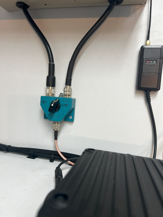

WSBR383 Posted July 15, 2024 Author Report Posted July 15, 2024 I am using a https://shop.mygmrs.com/products/nagoya-gpk-01-nmo-ground-plane-mount-kit for the SB-790A, the two antennas are probably 25 to 30' apart. The SB-790A states that you don't need radials, but I tested with and without and my results were slightly better with, so I keep them on. I use a DAIWA switch DWS-CS-201A, and the loss is so minimal, I get less than 0.1db. Daiwa states 0.2db, but my loss is less. 1.6 VSWR is acceptable in theory, but you are losing RF. Do you have your LMR-400 going directly into the radio with no other junctions or adaptors? Are your connectors good and there is no excessive kinks in the cable? Also, I put three ferrite beads as close to the connector attaching to the antenna on both runs of LMR-400, what is your reflected? That could be an issue. What meter are you using? And have you tried an antenna analyzer? Quote

WSBR383 Posted July 15, 2024 Author Report Posted July 15, 2024 (edited) Tico, on the Fong, I am also using HVAC nylon zip ties instead of metal hose clamps or clasps as to not have any metal anywhere near it. In my experience that does make a difference. Yes also on a PVC mast, thicker of course, and I made it adjustable for a service if necessary https://www.amazon.com/gp/product/B0C61V8TCS/ref=ppx_yo_dt_b_search_asin_title?ie=UTF8&th=1 Edited July 15, 2024 by WSBR383 Reloader762 and RayDiddio 2 Quote
