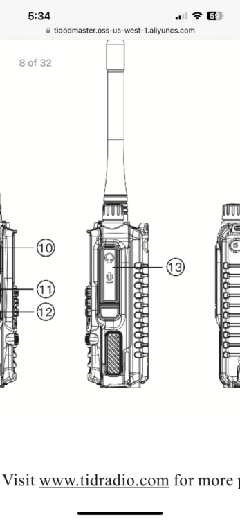

WSAB572 Posted July 9 Author Report Posted July 9 is there a way to connect the th3 with speaker.. what type of connector ? Quote
LeoG Posted July 9 Report Posted July 9 On the side there are two connectors for the mic and programming. One of them is the output to an external speaker. Not sure which is which though. WSAB572 1 Quote
SteveShannon Posted July 9 Report Posted July 9 3 hours ago, LeoG said: On the side there are two connectors for the mic and programming. One of them is the output to an external speaker. Not sure which is which though. It’s molded into the cover. The top jack is for the headphone. The bottom is for the microphone. Both are necessary for programming unless you’re using Bluetooth. WRHS218 and RayDiddio 2 Quote
