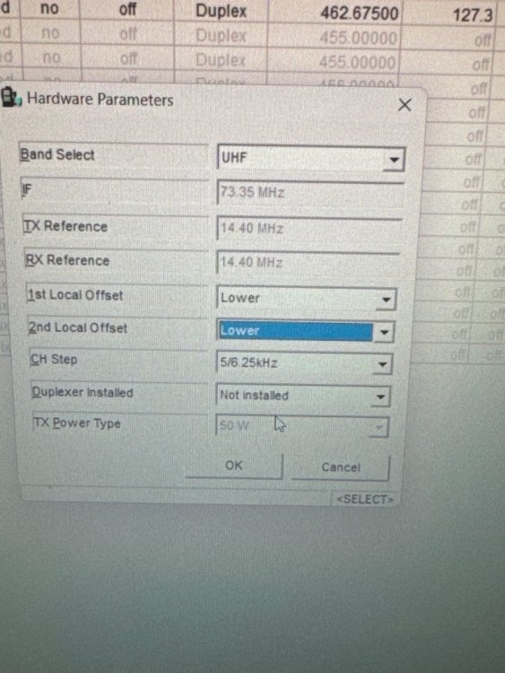

WRYG716 Posted August 9, 2024 Author Posted August 9, 2024 I can run the programming software and see the frequencies that are programmed in. Rx 467.6750 Tx 462.6750 127.3 tone on handheld of course I have those flipped Quote
Radioguy7268 Posted August 9, 2024 Posted August 9, 2024 If you have the programming software & can read the repeater, then you have pulled the codeplug already. If the information programmed into the repeater is what you requested at purchase - and your portables are programmed in the reverse (Portable transmits on 467.675 & receives on 462.675 with a matching tone of 127.3) then the programming would appear to be correct. Double check frequencies in the portable. I will assume that your two portables will communicate with each other on a common simplex channel (ie: 462.675 for both transmit & receive). If that's all true, then I'll say it once more - call the seller & see what they advise. SteveShannon 1 Quote

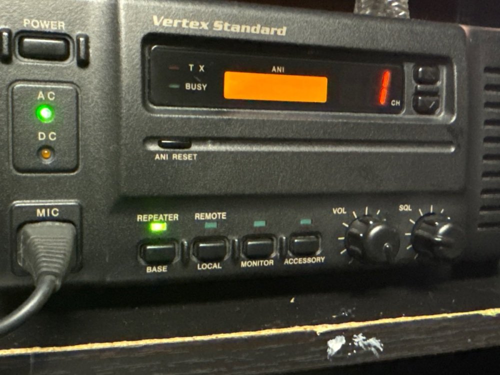

WRYG716 Posted August 10, 2024 Author Posted August 10, 2024 My busy light is staying on. The squelch is turned all the way up. Is that normal? if I turn the repeater off and back on it goes away. Quote

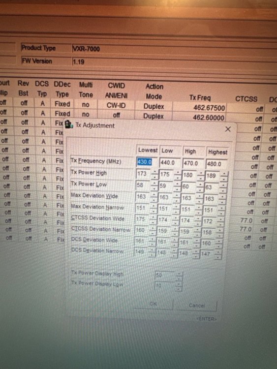

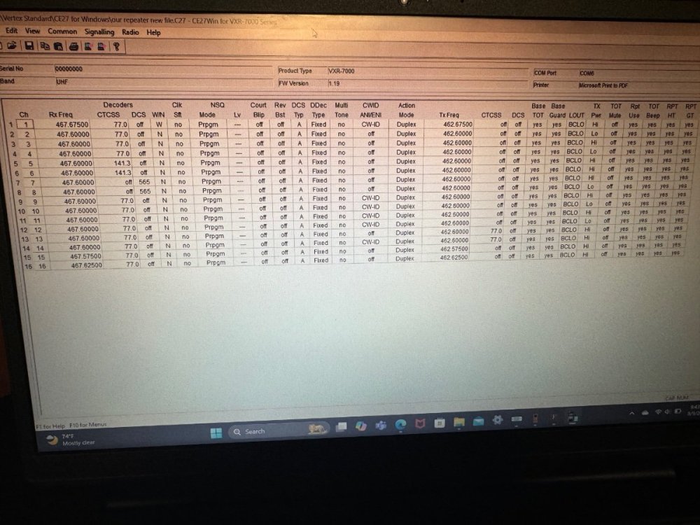

Radioguy7268 Posted August 10, 2024 Posted August 10, 2024 According to that picture - your repeater is set to 467.675 Receive - but with a tone of 77.0 Hz. I believe you said your portable had a tone of 127.3 ?? The repeater needs to have the same PL tones as the portables. Your transmit appears to be set to CSQ (no tone at all) with a frequency of 462.675. If the portable radio you are using is set up with a PL on the receive, you would not hear the repeater. (You should still see a 'busy' LED when the carrier comes up on channel). It appears your frequencies are correct - but you need to match your tones on your portables and your repeater. If you can key the repeater with a local mic plugged in - the repeater will just be transmitting on the base of 462.675 SteveShannon 1 Quote
WRYG716 Posted August 10, 2024 Author Posted August 10, 2024 I changed it when I used his file. Left everything the same but the frequencies. I of course changed the pl in the handheld to match Quote

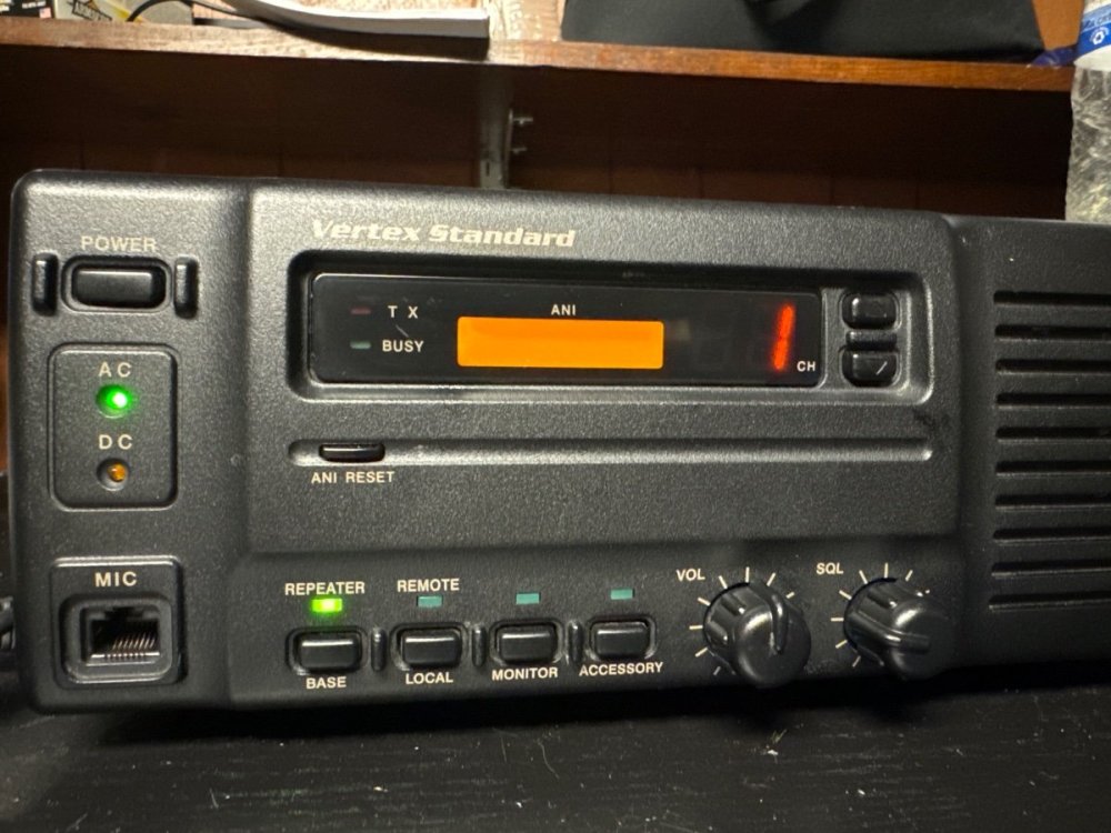

WRYG716 Posted August 10, 2024 Author Posted August 10, 2024 When I try to key up in base it just beeps at me. If I key up in repeat the tx light comes on? this is with the hand mic Quote
Radioguy7268 Posted August 10, 2024 Posted August 10, 2024 The transmit light should come on. That's normal operation for a repeater that's being keyed with a hand mic. If you have a receiver (portable) listening on the 462.675 - then put it in Monitor (disable the PL tone). If your repeater is transmitting on that frequency, you will hear it. Even if the repeater has a bad amplifier, or the duplexer is totally hooked up wrong, you'll still hear the output if you're in the same room with a portable listening on 462.675 If you can't get that - then you are NOT transmitting on 462.675. There's a limit to the amount of help you're going to get online. At some point, you need to be able to troubleshoot step by step & figure out what you have, and what you don't have. Throwing darts at a virtual dartboard for tech help is not the answer. Quote
WRYG716 Posted August 10, 2024 Author Posted August 10, 2024 6 minutes ago, Radioguy7268 said: The transmit light should come on. That's normal operation for a repeater that's being keyed with a hand mic. If you have a receiver (portable) listening on the 462.675 - then put it in Monitor (disable the PL tone). If your repeater is transmitting on that frequency, you will hear it. Even if the repeater has a bad amplifier, or the duplexer is totally hooked up wrong, you'll still hear the output if you're in the same room with a portable listening on 462.675 If you can't get that - then you are NOT transmitting on 462.675. There's a limit to the amount of help you're going to get online. At some point, you need to be able to troubleshoot step by step & figure out what you have, and what you don't have. Throwing darts at a virtual dartboard for tech help is not the answer. What I’m trying to say is when I put it in base and key the mic it just beeps. No light. When in repeat mode it keys up but no receive on handheld or base station. Shouldn't it key up on base? Quote
