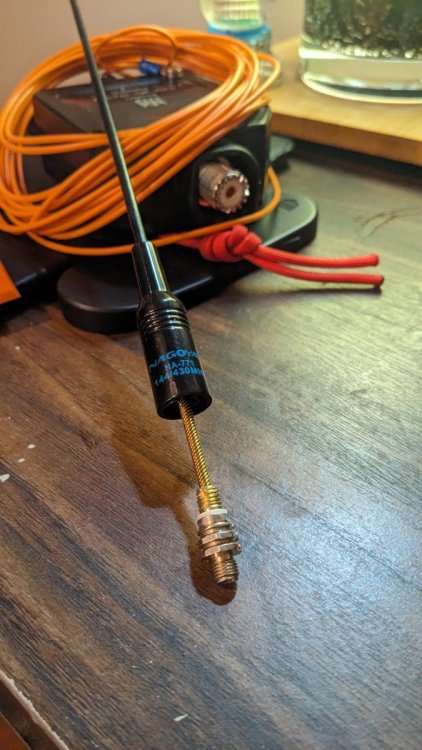

Mine was a TidRadio 771, but it has a coil and a capacitor from partway up on the coil to the shield. Here’s my picture.  Notice how thin the coil wire is?  I bet yours has a coil under a layer of insulation and it’s just not visible.
<snipped image, good image by the way!>
Nope, no coils. The shell is empty and what you see in the picture is what is there. The center "element" spring, what have you is crimped directly to the connector center conductor. what you have is what I expected to see when I popped open the assembly, which was super easy, I just partially screwed an adapter to the antenna ant put a screwdriver between the plastic cover and the adapter and pried it off. Caveat, I had been smacking stuff with the antenna too amuse myself so I bet I fractured the super glue holding it together. It smells like that.
You wuz took!
Actually, if you bought it as a GMRS radio (single band) there’s probably no need for a coil and capacitor. They’re there on my antenna because it was a dual band antenna.
