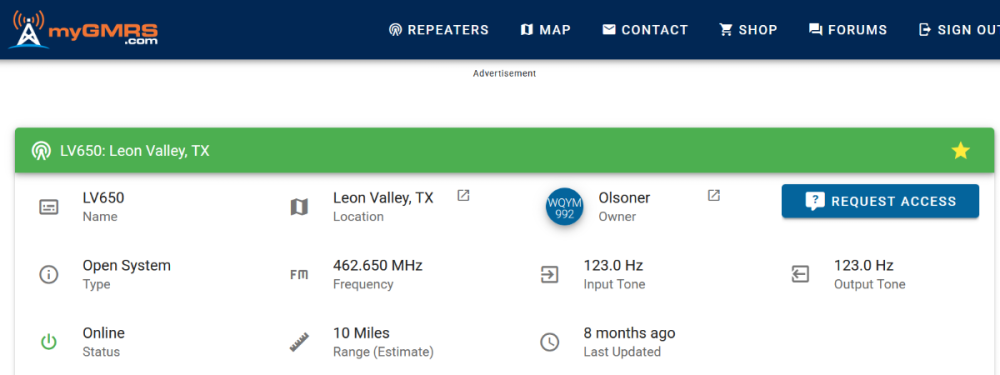

WSGL775 Posted January 10 Report Posted January 10 Okay everyone, I'm dense and I can't figure this out. I'm asking for assistance to access a certain repeater. Here's the particulars: 1. Using a Baofeng UV-5r Gmrs radio. One of my HAM friends told me that I cannot use this radio for GMRS. I think that I can. 2. I'm using CHIRP software and have attached screen shot of my program 3. Trying to link to repeater LV650 on mygmrs.com. I receiver permission from owner to use this repeater. I can't figure out why I can't reach this repeater. Any help would be greatly appreciated. It's frustrating when you know hardly nothing about how this works! Quote
SteveShannon Posted January 10 Report Posted January 10 27 minutes ago, WSGL775 said: Okay everyone, I'm dense and I can't figure this out. I'm asking for assistance to access a certain repeater. Here's the particulars: 1. Using a Baofeng UV-5r Gmrs radio. One of my HAM friends told me that I cannot use this radio for GMRS. I think that I can. 2. I'm using CHIRP software and have attached screen shot of my program 3. Trying to link to repeater LV650 on mygmrs.com. I receiver permission from owner to use this repeater. I can't figure out why I can't reach this repeater. Any help would be greatly appreciated. It's frustrating when you know hardly nothing about how this works! John, We must both be equally dense. It looks like you have it set correctly. Try getting closer to the repeater. WSGL775 and WRUU653 2 Quote
WRZD706 Posted January 10 Report Posted January 10 You need to program a +5.000 offset on the that repeater channel ... line 27 in the pic. That way when you hit the transmit key to talk your radio will use frequency 467.650 with a tone of 123.0, but your radio will listen for a response on frequency 462.650 with no 123.0 tone (because you picked "tone" instead of "TSQL"). Make that change, go outside, key up on that channel and ask if anyone can hear you. And, don't listen to your friend about your non-type certified radio. Just enjoy your new toy for all that it can do. No one will know. More importantly, no one important will care if your radio isn't GMRS type certified. WRUU653 and SteveShannon 2 Quote

SteveShannon Posted January 10 Report Posted January 10 1 hour ago, WRZD706 said: You need to program a +5.000 offset on the that repeater channel ... line 27 in the pic. That way when you hit the transmit key to talk your radio will use frequency 467.650 with a tone of 123.0, but your radio will listen for a response on frequency 462.650 with no 123.0 tone (because you picked "tone" instead of "TSQL"). Make that change, go outside, key up on that channel and ask if anyone can hear you. And, don't listen to your friend about your non-type certified radio. Just enjoy your new toy for all that it can do. No one will know. More importantly, no one important will care if your radio isn't GMRS type certified. This is exactly right. In my defense, because it is a GMRS radio, the channel should have the offset baked in to the channels between 23 and 30. Or did I misunderstand it being a GMRS radio? WRUU653 1 Quote
WSGL775 Posted January 10 Report Posted January 10 I guess I wiped out all that stuff in chirp. It was there in the beginning. This is on me. I flashed the radio and inputted the channels back but did not put the offsets back into the program. Thank You Jim! I get confused easily..... WRUU653 1 Quote
