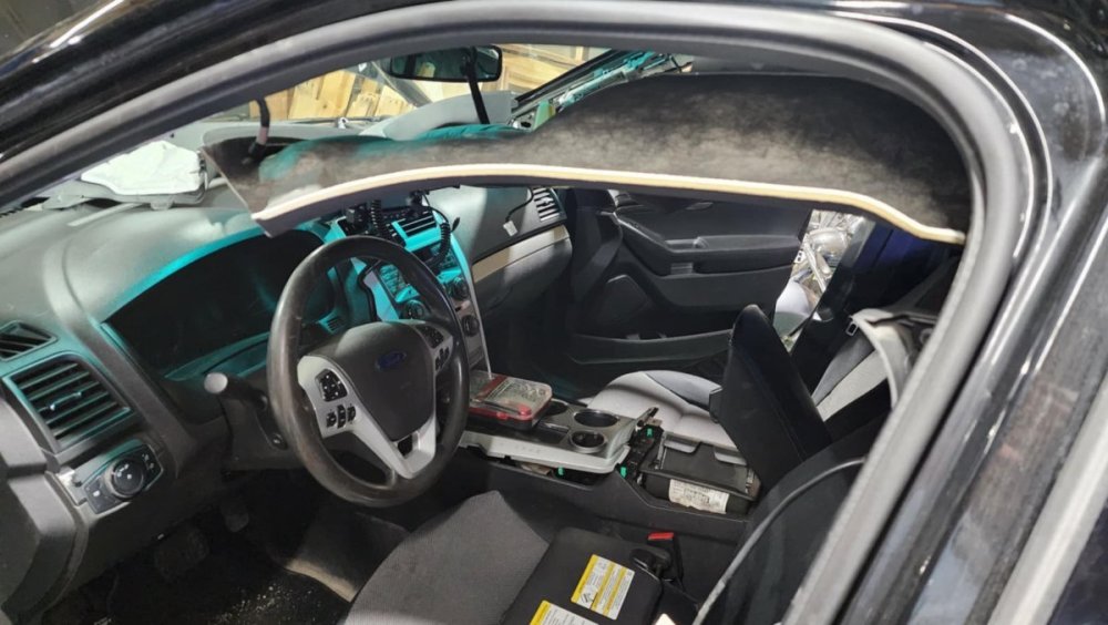

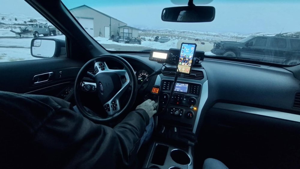

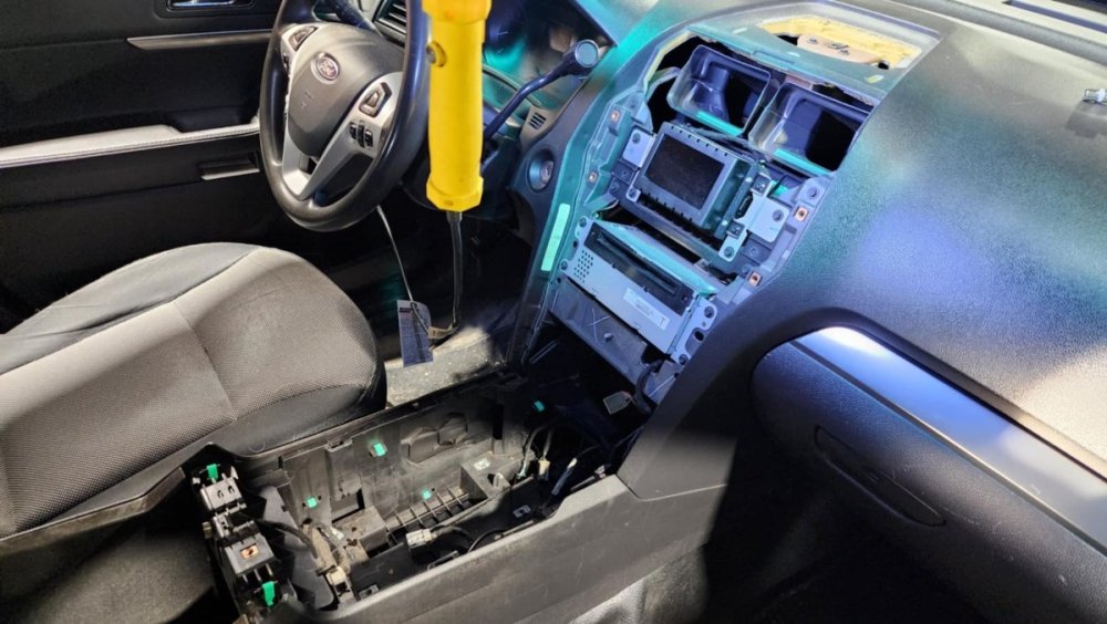

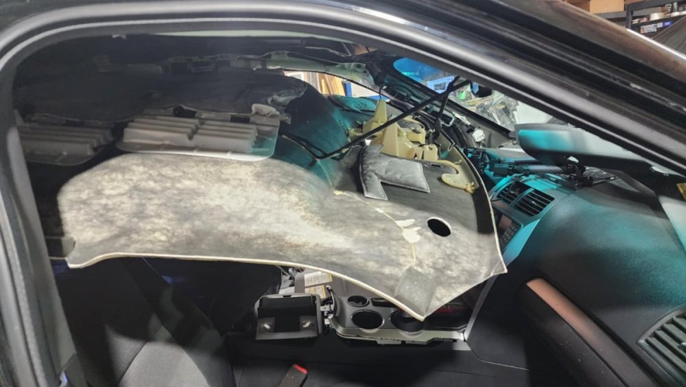

I just installed a dual band Alinco DR-735T, in the Ford Police Interceptor.  I used a Bulletpoint mounting system, which greatly speed up the install.  On the roof, I installed a small 3" stubby antenna.  I was able to hit our local repeater with a strong signal, about 35 miles away.  Quite a lengthy install.  Took the headliner down and dismantled the center console to run wires.  Not my first install, by any means, but still quite a process to get it to the factory look.
This was my first headliner.  I found a guy on youtube who "de-policify's" (his term) interceptors.  I've spoken with him on the phone and that really boosted my confidence.  I used to install radios, C.B.'s, etc, back in the 70's and 80's, and it was a totally different animal back then.  Now, the headliner is one piece and solid, instead of a glued on fabric.  Just had to remove the pillar coverings, which are snapped in, and the whole thing just fell down!  Easy peasy.
