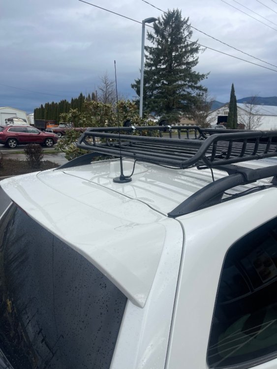

  6. Installed the new antenna tonight. I think it’s better - still the same swr reading (1.00 - 1.02). I think I’m getting a lot of popping and scratching from all the overhead lines around here. Seems to work well in the middle of my yard and I’m reaching repeaters 45 miles away. I’m done with the antenn for now. really appreciate all the help guys!!

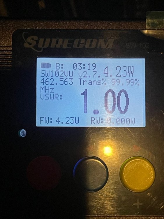

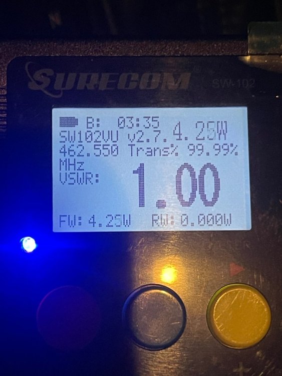

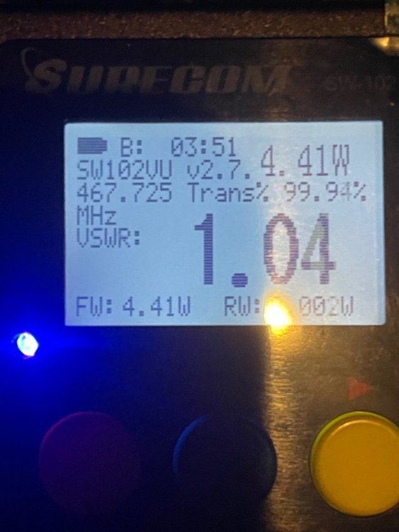

  7. Ok - updates. I received a replacement antenna from Amazon tonight after explaining my situation to the seller (btech). Also recieved swr meter so decided to test the current setup and I’m shocked. these are on channel 1, 15, and 30. Does this seem right? Higher wattage than expected from my baofeng uv-9G too.

  10. Before I mounted it on my car - I put the magnet on a cookie sheet and put high in my loft in my house. Wasn’t able to reach any further than I could with just the HT antenna. Maybe even worse then too - just figured I wasn’t getting a good ground plane. Maybe that was a sign something wasn’t right
  11. Took the roof rack off and slapped it right in the middle of the roof. Tried to reach a repeater about 31 miles away and wasn’t able to ping it (no mic attached) . Stepped out and put my 771g on and instantly got a response from the repeater. Gotta be something jacked up with the adapters where it necks down to my HT or somewhere in the coax itself. I’ll wait and check Tuesday when my meter comes. So frustrating.

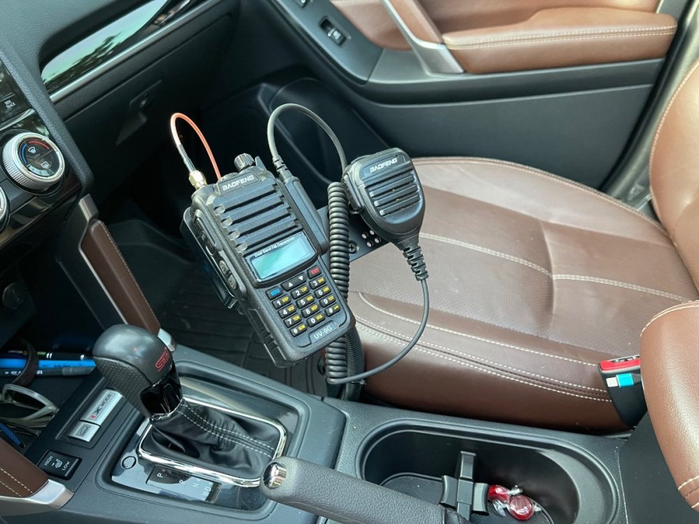

  14. Thanks guys - sounds like I need to eliminate some variables. I think first I’ll take the rack off and move the antenna to the middle of the car. I really appreciate the feedback. If it works at least as good with the mobile setup as it does standing outside the car, I’ll be happy.
