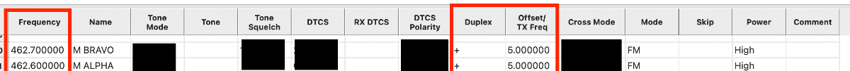

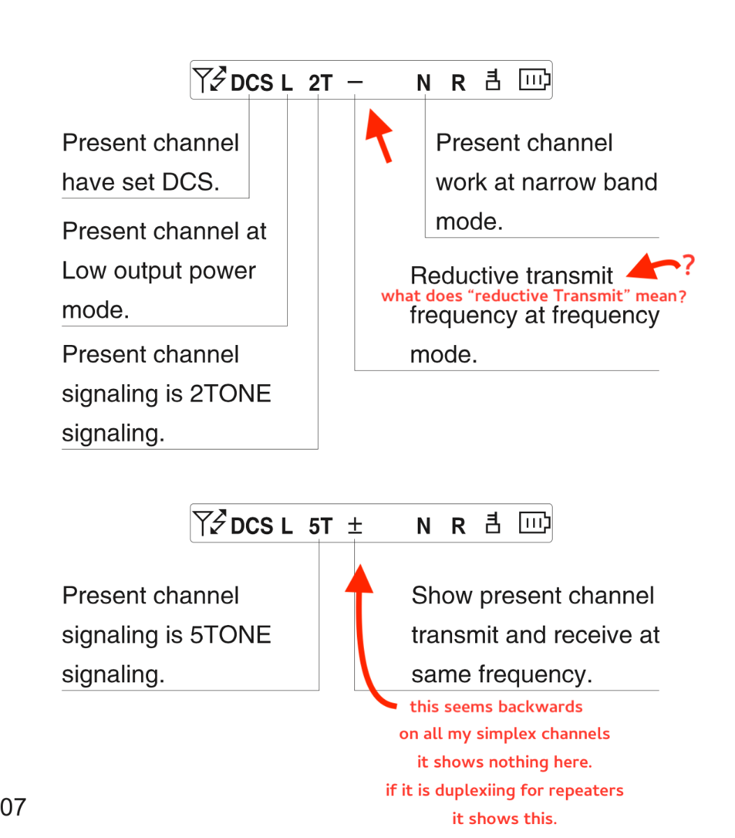

This seems wrong in the manual... would not be surprised.. the manual is littered with badly composed English. In CHIRP it shows + 5 for TX... and this is what it shows on the screen to indicate it is +5 duplex.- 40 replies

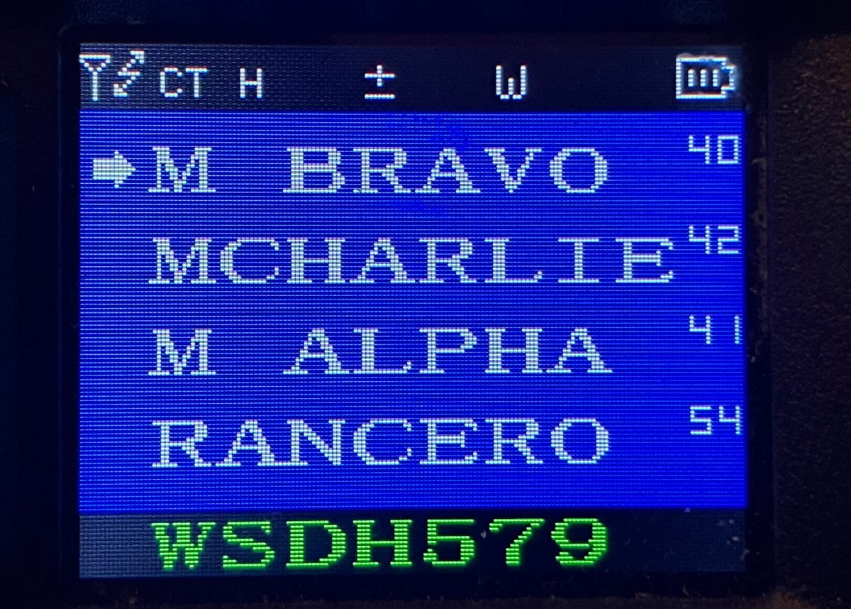

From day one it only ever showed that plus with the line under it... and was working fine. is the line under the plus the negative offset indicator or just an underline? and it is a GMRS only radio... why would it ever show negative offset?- 40 replies
