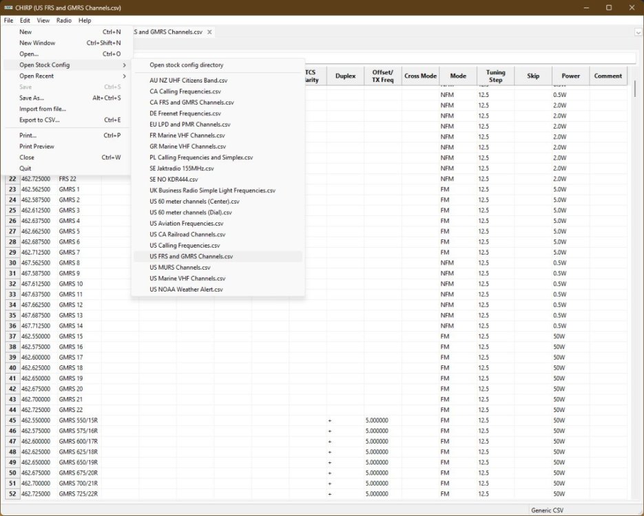

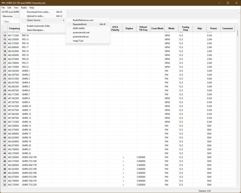

  3. Thank you for the info and great read! A few of my WIBNI items: SK1&2 (or other unused long-press key) nuisance channel skip/temp channel delete from zone scan. Similar to AnyTone 878 Plus' nuisance delete, power off/on should restore channel scan preferences to baseline. SK1&2 (or other unused long-press key) quick access to user-assigned zone/channel bank. Ads and manual (page 9) advertise 10 squelch levels, but there are only 5. Would love 10 squelch levels. User access via CPS to the squelch granularity assignment tables per frequency band. Similar to CHIRP's Settings > Service Settings for BF-F8HP, CHIRP allows user to customize BF-F8HP's keypad squelch settings (0-9) to the more granular values (0-123) per frequency band. Would be awesome if the BF-F8HP PRO CPS UI allowed the same user customization of squelch tables on a more granular level and on a frequency band basis. As is, adjusting BF-F8HP PRO squelch is an exercise in futility. 5. Also... it would be nice if users could import data from stock/standard frequency tables and import data based on DB queries a la CHIRP: Incorporating this import functionality would help reduce manual typing/plugging in data or running CHIRP in tandem with CPS to copy/paste data rows between apps.

  5. As of CHIRP next-20250328, zone entries are: Zone 1: row 1 - row 100 Zone 2: row 101 - 200 Zone 3: row 201 - 300 ... Zone 10: row 901 - 1000 Zone names are editable and located under Settings > Bank Names
