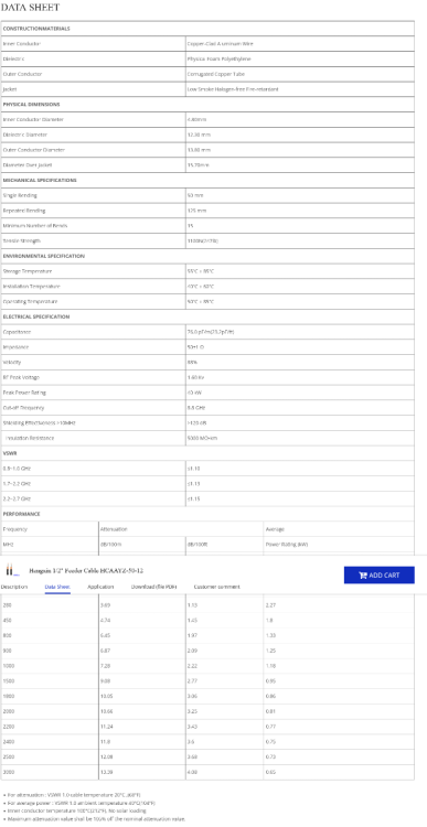

  6. This is the duplexer I am ordering and of course using 1/2 Heliax cable and the actual repeaters are Kenwood TKR-851K units UHF Duplexers.pdf

  8. That will work bt being LMR400 and foil wrapped still I wouldn't use it... I would go with a Heliax Cable "All HELIAX coaxial cables are jacketed for direct burial or for corrosive environmental conditions. Standard jacketing material is weather-resistant polyethylene suitable for use in extreme climates."

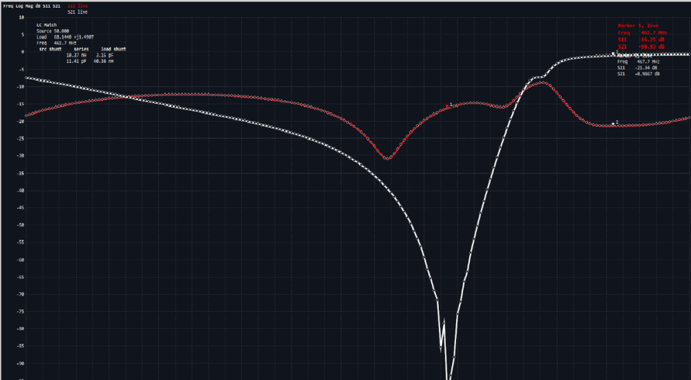

  9. Thank You for your input.... Tuning a duplexer was something i steered away from for my whole life but thx to Cheap NANOVNA's and You Tube i was able to tackle it... I have 7 repeaters i bought at Gov Auction TKR-851's and all have duplexers I have tuned 2 for 462.6 and 2 for 462.7 so if a failure its a fast cable swap and in goes a whole new repeater.... still waiting on linking hardware so i can link my 2 running repeaters to make my group happy.... now if i could understand how to have 2 repeaters with duplexers on 1 antenna then i could offer to separate systems to my users
  10. I am using a SAA-2N NANOVNA with the Nano VNA app for PC the notches vary from 85ish to 103ish i have tried to get them tighter but i believe my resolution just isnt good enough was just trying to save $200 for tuning from the shop I do like that my S21 was able to get to -0.96 so 1DB loss i assume for transmit and receive which is way better than my Chinese flat pack that is -2.3DB just wondering if you think it will be an improvement over my current installed Chinese Duplexer
