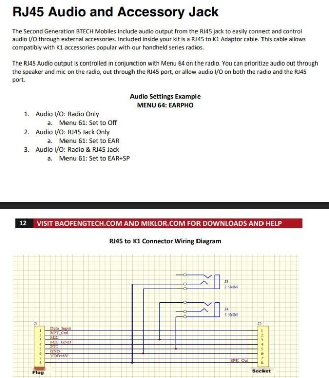

I'm trying to take the audio out from a BTech GRMS-V2 radio and take it to an audio-in on my PC. Does anyone have any solutions or ideas for making this work? My PC refuses to see it as an audio-in source.

Why not? I was wanting to do the same thing on the base station. If I'm sitting at my PC with speakers on ether side of my monitor for the computer, it would be nice to route/mix the radio output to those same speakers.
Back to the OP: The -V2 should have came with a RJ-45 accessory/breakout cable. You can change the speaker output settings in the menu to "EAR" (earphones) or "EAR+SP" and run a 2.5mm patch cable to the audio input/mic jack of the PC and you should be fine.
