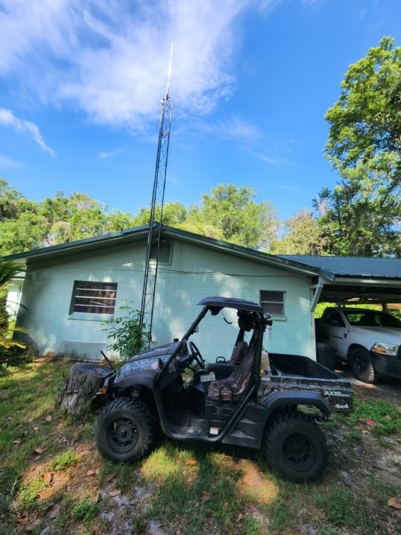

I don't have any of that stuff. 30' tower with MA09 High Gain 462~467MHz GMRS Omni-Directional Base Antenna & 50-3 Pure Copper Coaxial Extender Cable For RT97L.

Correct I got it as a package deal with the antenna, mic & cable. I can get about 1 1/2 miles west of me though the old oak woods & about 3 miles east though the pastures. So you guys think I need a better cable.? My antenna is a
MA09 High Gain 462~467MHz GMRS Omni-Directional Base Antenna  4.5/7.2 dBi High Gain Fiberglass Antenna 5.75’

We can break your bank guessing at what the problem might be. My feeling is that your antenna probably isn’t higher than the surrounding terrain and trees. Getting it higher can help but UHF does poorly in vegetation. Poor cable contributes by attenuating the signals in both directions, but antenna gain and visibility is by far the most important factor.

Getting twice the distance through the pasture compared to the woods tells part of the story. Southern pines are easily 50' tall.
