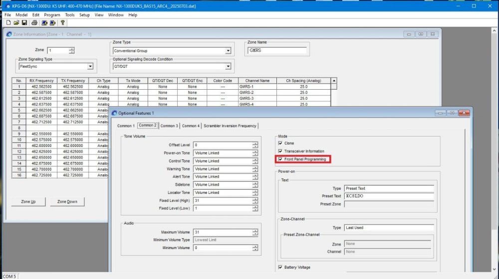

UncleYoda Posted July 29 Report Posted July 29 Yes, if you want to follow the rules, you need a GMRS certified radio. (If you suspect a vendor is lying/cheating on their certification claim, you can look up the ID on the FCC site.) The part about "locked" though is not as simple. Some certified radios do allow adding extra transmit channels on the same frequencies. It's the frequencies that need to be locked for transmit, not specific channels. But the CCR manufacturers or vendors take the quick and dirty way to lock by channels. Quote
