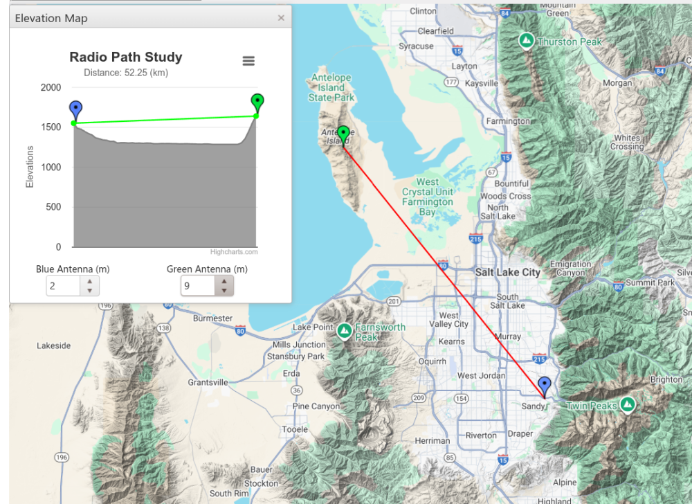

3cRadio Posted 5 hours ago Author Report Posted 5 hours ago 6 hours ago, dosw said: You think that's amazing, consider that with a handheld Yagi antenna an amateur can talk through the International Space Station's 2m/70cm (VHF/UHF) crossband repeater using a 5w handheld radio. Five watts, to reach a repeater hundreds, even a thousand miles away. But what's different about the ISS? It's not that the repeater is a ham repeater. It's not that the repeater has some amazing antenna. It's not that it's got a million dollar radio. It's that there's nothing between you on the ground, and the repeater up in space. Line of sight. So if you're able to reach a repeater 75 miles away reliably from an antenna that is 10 feet above the ground, that repeater's antenna must be at about 1050 feet above the ground between the two of you. Otherwise the curvature of the earth gets in the way. As an example, I can easily hit this repeater: But I can hit it because I live at 1600m, the repeater is at 1700m, and everything between us is at 1200m. We have line of sight. thanks for the reply! pretty amazing that a 5w radio can make it up that far. since earth has the whole coverture thing and obstructions, i can see why it might not go as far. from what i can gather, the tower is probably approx. 2k ft elevation and i'm at 100 ft. that image is pretty cool. cant seem to find the site you were using but here's my google map image. there are some hills but no huge mountains (from what i can tell). WRUU653 1 Quote

WRUU653 Posted 5 hours ago Report Posted 5 hours ago Here is the line of sight tool. I know that area. That is a good reach for sure. SteveShannon 1 Quote
