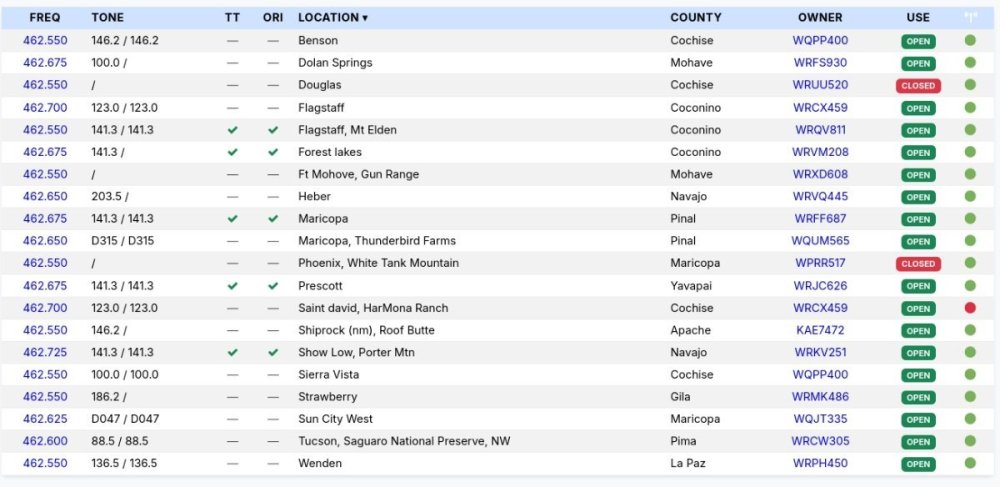

There use to be 4 or 5 repeaters that were in the Phoenix area that I could hit, now I only see one, Phoenix 650 as being up and running. What's happened to all the GMRS Repeaters?
Here's a list off of RepeaterBook. There's only 20 Repeaters and 3 of them are down so that leaves 17 for the entire State of Arizona.

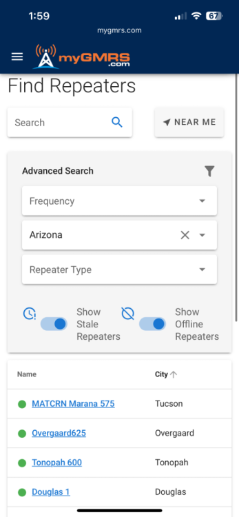

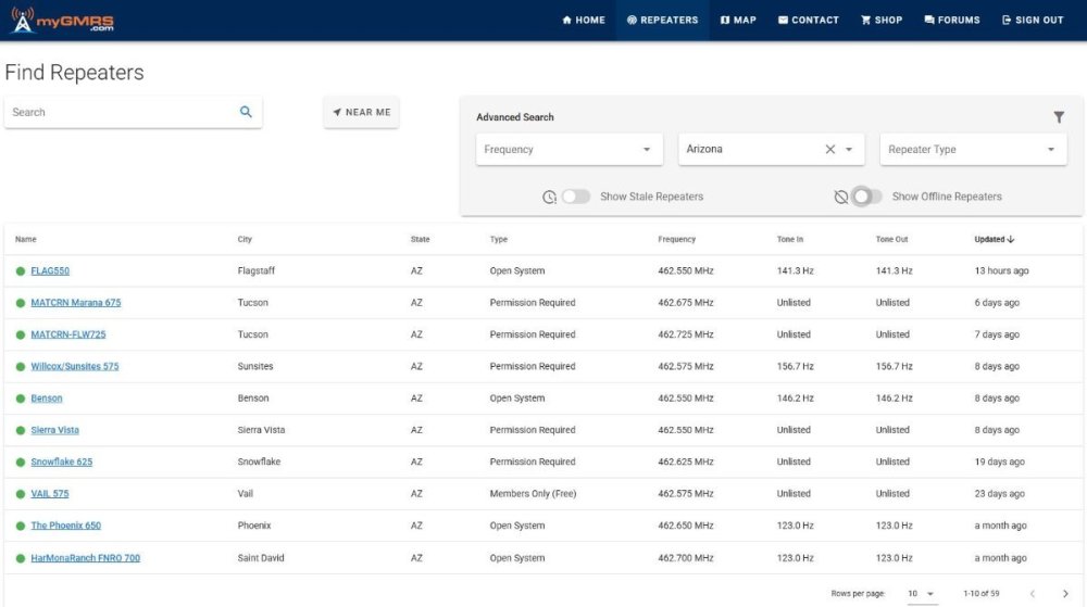

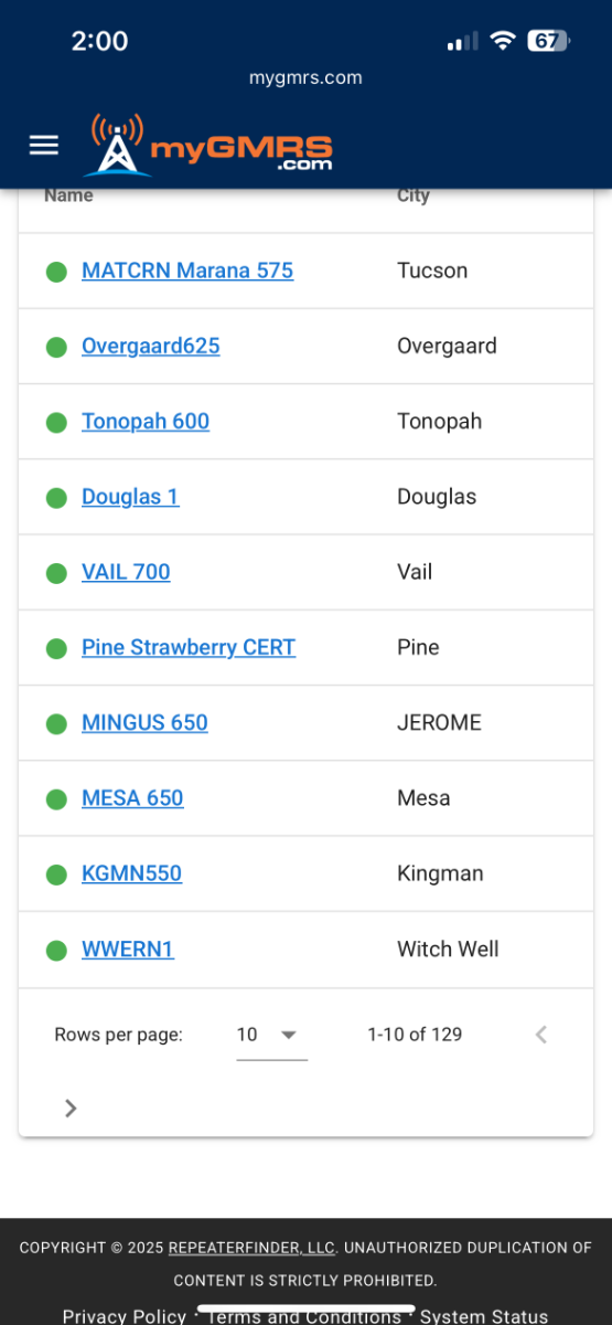

For your Phoenix batch, are they offline as in tried using them and no luck? Or not showing up in the listings?
  The listings here will drop a repeater to "stale" if it hasn't been updated in awhile (1 year, I believe), and you have to turn on the "show stale repeaters" option in the list/map to see they're still there.
